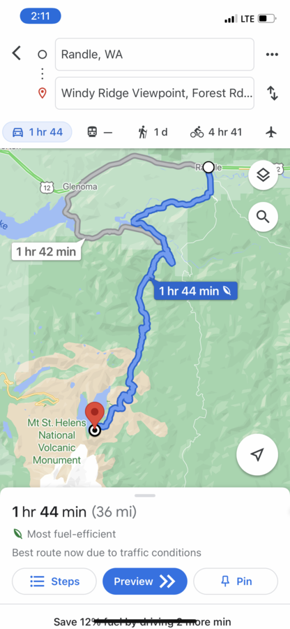

                  Mt St Helens. It’s closed in the winter so this route isn’t exactly correct, I mostly drive NF-25 which is the other twisty road going south from Randle, and then there’s a turnoff to Windy Ridge.
