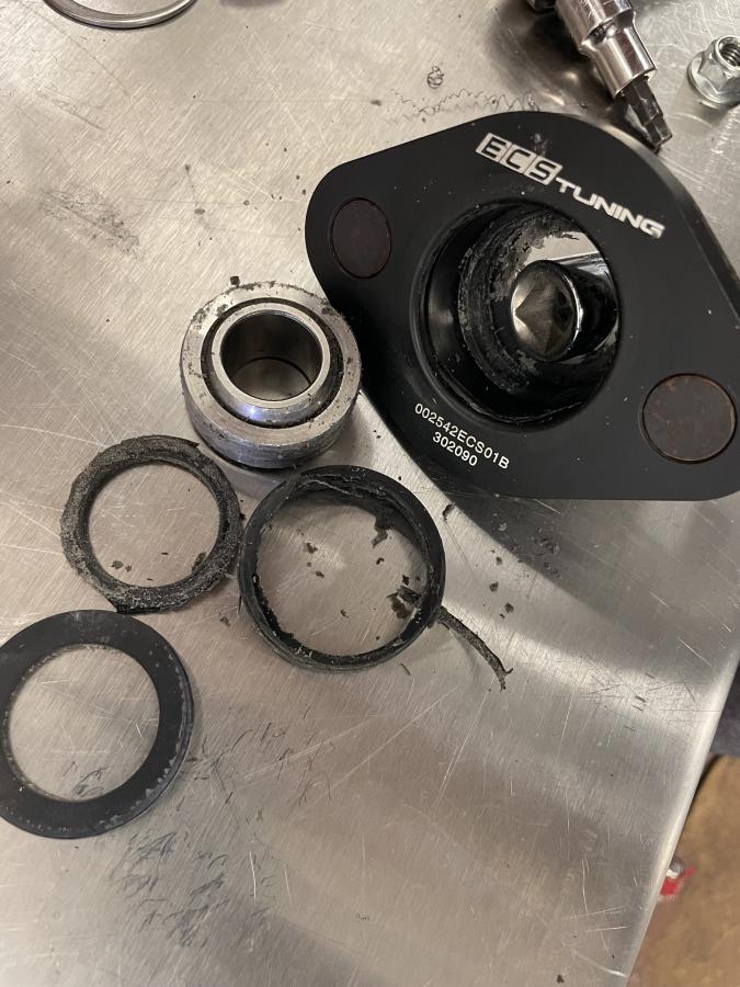

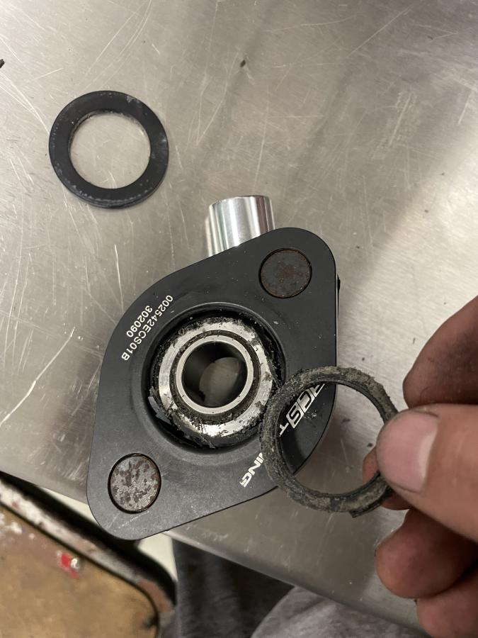

        Update: hadn't touched the car for months. Finally pulled it apart, and the RSM failure was catastrophic due to poor design; the monoball was actually fine. Urethane bushing completely disintegrated itself on the top side; shavings all over the top of the shock tower inside the trunk and what was left of the bottom half was only contained by the washer/cover. Car sounded like someone was in the trunk with a baseball bat.
        So heads up if you have these they WILL eventually fail.

          And just to show they were assembled correctly. Notice how much play just using two fingers (that's what she said)

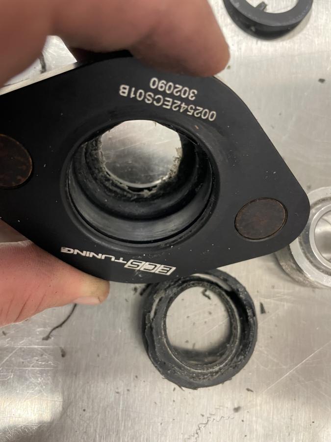

            I鈥檓 also a victim of this crap ECS Tuning part , passenger side failed after 11k miles. It鈥檚 been installed for about 6 years- the occasional clunk started about 18 months ago and total failure about a week ago. I stopped buying parts from ECS in 2022 so this is the final nail in the coffin for my relationship with ECS. Unfortunately it seems many of the BMW parts e-tailers are owned by the same PE firm so best I can do is to trust other OEM+ parts.

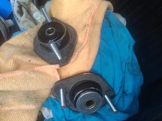

              I have the RE's, they seem to be a good stock-like design.
              Meyle has their Heavy Duty version as well, that honestly might be the best all-round choice for a street car.

                      RE are fine. They're actually a copy of TCK (who used to produce them for Rogue actually).

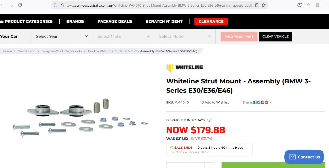

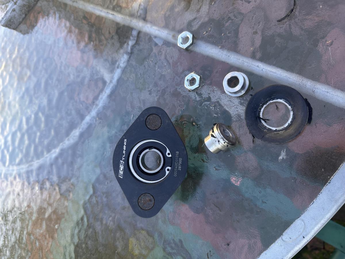

                        Holy Smokes, thanks for the heads up man
                        I been chasing a rattling at the back of mine today
                        I know my RACP is cracked and just thought the noise was the panel shifting around
                        Didn't think twice about the whitelines i installed 18 months ago
                        Click image for larger version  Name:	WHL.jpg Views:	0 Size:	120.4 KB ID:	332140
                        I will rip them out tomorrow and inspect
                        Any links or part numbers please for Meyles ?

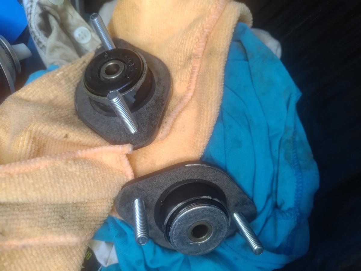

                                Thanks Cubie
                                They arrived finally and installed, absolute heaven in comparrsion to the junk whitelines, cheers
