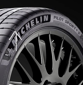

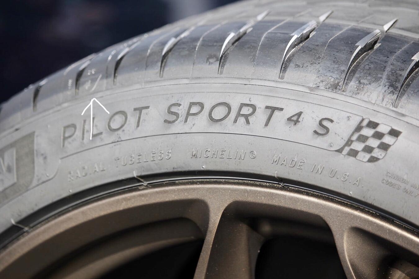

      Now that everyone who’s knowledgeable has weighed in on the topic, it’s time for the peanut gallery (me 🤪) once again to provide my 2¢ worth of opinion. 🙃 I’ll present some pics, then move onto general blatherings, and opinion.
      The Pics
      On the transition between the most outer tread block and sidewall, there is usually a marker of some sort. To use a Forum favorite as an example, the Michelin P4S, this indicator is identified by the white arrow. I use this factory marker to judge tire pressure. Next, is how I do this.

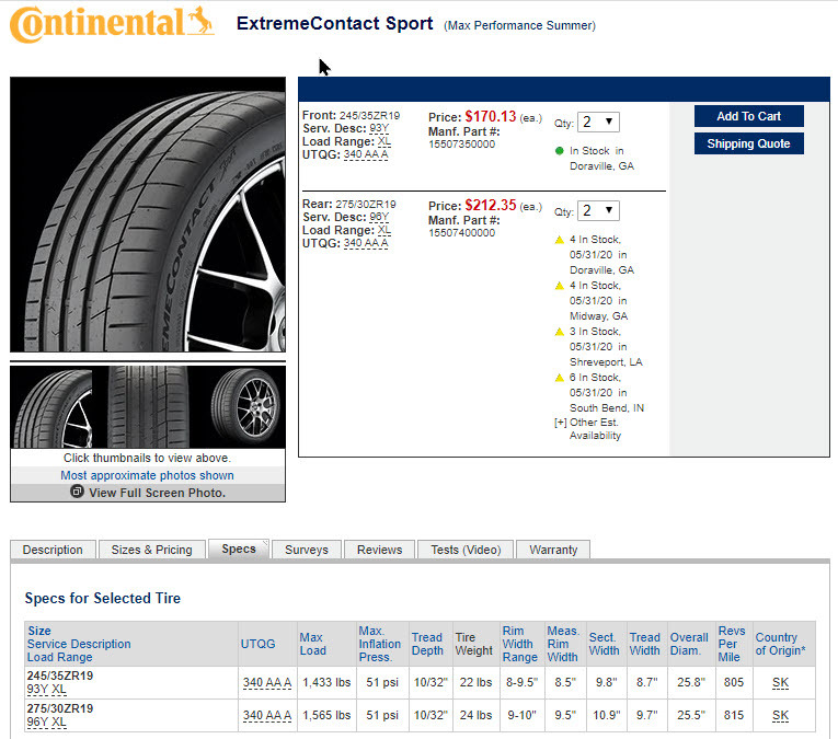

            Not so, good sir!
            Click image for larger version  Name:	2020-04-24_17-21-18.jpg Views:	0 Size:	174.3 KB ID:	16980
            front circumference: 25.8 * 3.14159 = 81.053"
            rear circumference: 25.5 * 3.14159 = 80.11"
            I do understand that the DSC expects similar circumferences front to rear and that to achieve this with different section width tires front to rear the front will require a higher aspect ratio than the rear.
            My contention is that the recommended tire pressure difference front to rear plays no part in matching front to rear tire circumference, but is instead intended to reduce the likelihood of oversteer.
