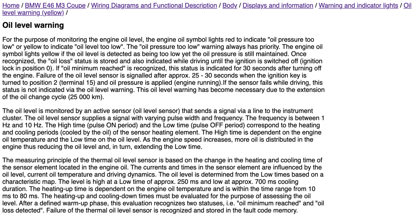

                        Fuse 30 is what I've seen referenced as being blown by the oil level sensor. However, it will not shut the car off, only prevent it from starting.
                        Your dealer is lying or ignorant.

                            Wall of text/pics warning, but I'm pretty sure the signals from the oil level and pressure sensors do not influence engine running or starting.
                            Here's what TIS has to say about the oil light:
                            Click image for larger version  Name:	Screen Shot 2022-01-20 at 10.10.59 AM.png Views:	0 Size:	708.7 KB ID:	149153
                            Notice there's no mention of switching the engine off when the oil level is too low.
                            Maybe some people have had it blow when their oil level is low, but I highly doubt the DME is purposefully blowing it. That fuse provides +12V to a bunch of engine components, including the oil level sensor.
                            The oil level sensor works by heating up a resistive element and measuring how fast it is cooled (by the oil). I suspect what is happening is that the lack of oil does not allow it to cool and the sensor ends up drawing enough current to blow the fuse.
                            In case anyone wants to read up on this/look at the wiring diagrams/show this to the dealer, the info can be found in the "BMW E46 M3 Coupe / Wiring Diagrams and Functional Description / Body / Displays and information / Warning and indicator lights" section of TIS.
