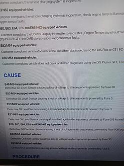

      There was a SIB years ago, complaint was no start and the fuse was blown being caused by a faulty oil level sensor. When we would get the car we'd see the blown fuse, unplug the oil level sensor, replace the fuse and the car would start. I can't recall the SIB # though.

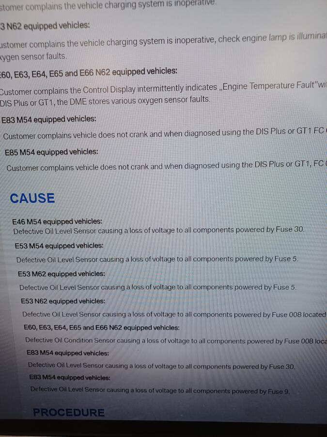

        SIB 12 33 06
        Click image for larger version  Name:	20220121_120528.jpg Views:	7 Size:	101.5 KB ID:	149362
        There's another spot where it says it CAN cause a no crank situation with a fault stored in the EGS. This may the issue you have. These sensors go out all the time.

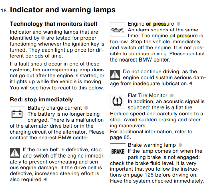

          A bad oil level sensor (short circuit) could blow the fuse but I don't think empty oil pan will blow it with ignition ON.
          George Hill had confirmed no alarm with red oil light. I read this from the M3 User Manual. Also, it says to switch off the engine (means DME or sensor doesn't do it automatically).
Name:	Red oil light.PNG

            SIB 12 33 06
            [URL=filedata/fetch?id=149362&d=1642784780][ATTACH=JSON]
            Sure, it was talking about defective sensor (bad with short circuit) and not empty oil pan.
