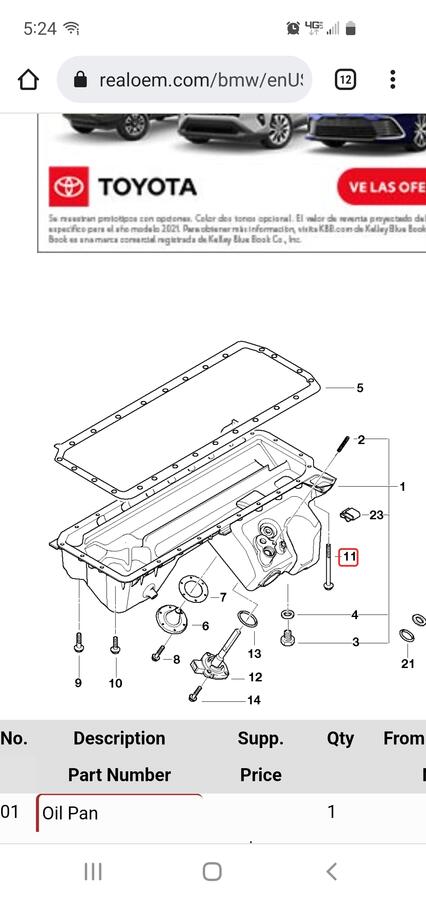

    That bolt looks as though it could be part #11 on the realoem diagram and it lists a quantity of 2, so these longer bolts may be used on both corners in the rear corners of the oil pan.

      Thats an oil pan bolt, I suspect the inside of the gasket is torn, allowing oil to see into the bolt
        Thanks guys, is there anything I can do about it? The oil pan gasket was recently replaced before I bought the car, and this is the only point that’s leaking.
