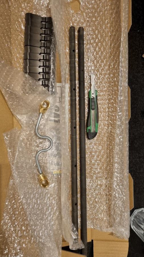

                    I've got the cams and dlc followers going in the car.
                      Here's my stash that arrived today.
                      Nuts that this stuff costs so much, but I guess that's how it is with material cost increasing across the board now and I imagine the followers must be rather labour intensive to manufacture as well as having a costly finalising procedure. You can spot the oil bridge oiling hole there between cylinder 5 and 6, roughly where the knife blade sits.
                      Regards
