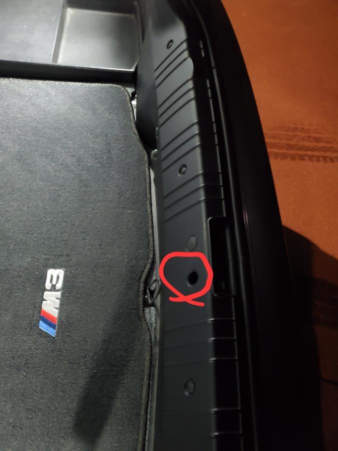

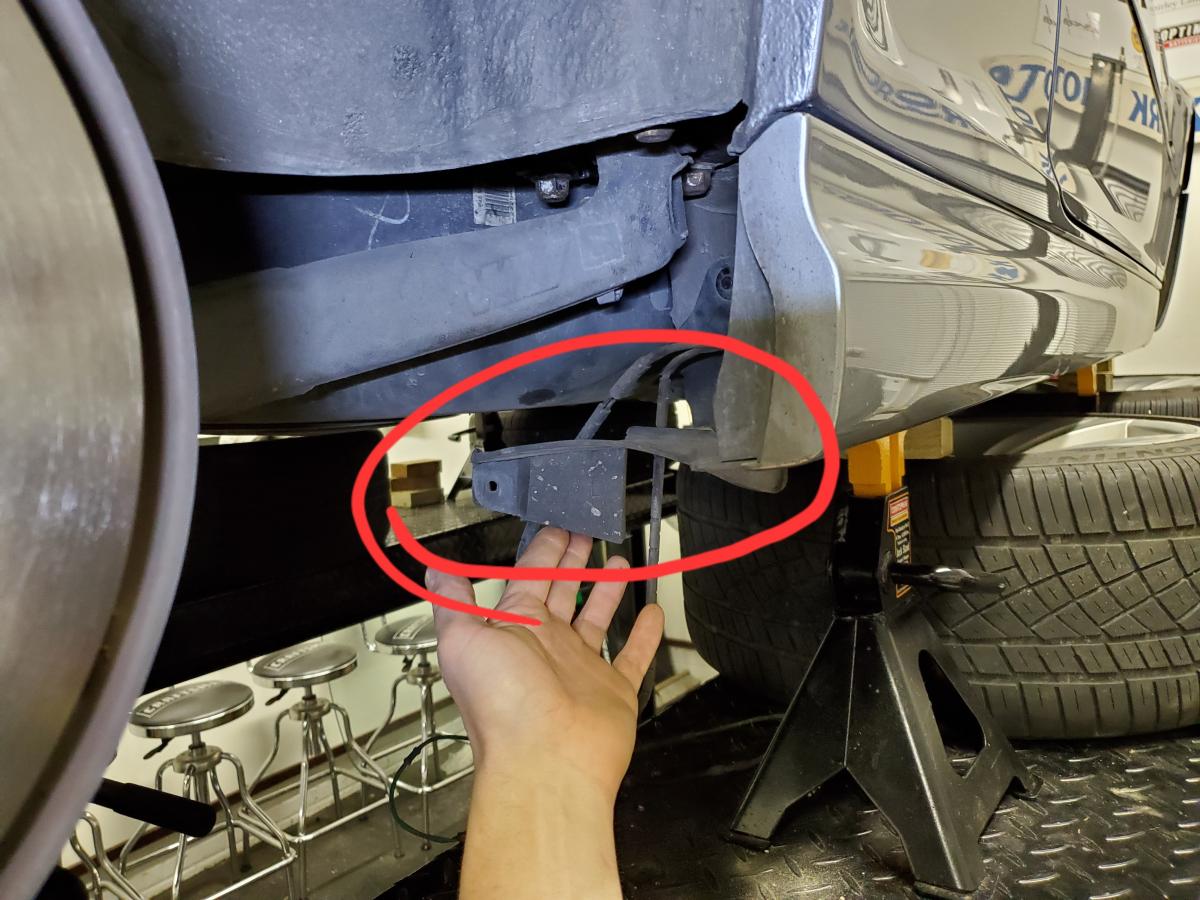

    I have been having issues identifying these two parts, one is a little flap that hangs down just in front of the rear wheels and the other a plug near the lower trunk latch.

    On man..I forgot to even look for a part # on the part itself.
    The Pass. side "flap" is:
    D.S is:
    Still need the plug #..
      https://www.ecstuning.com/b-genuine-...t/51718244046/
      D.S is:
      https://www.ecstuning.com/b-genuine-...t/51718244045/
      Yeah, I had to replace one side myself, broken somehow.

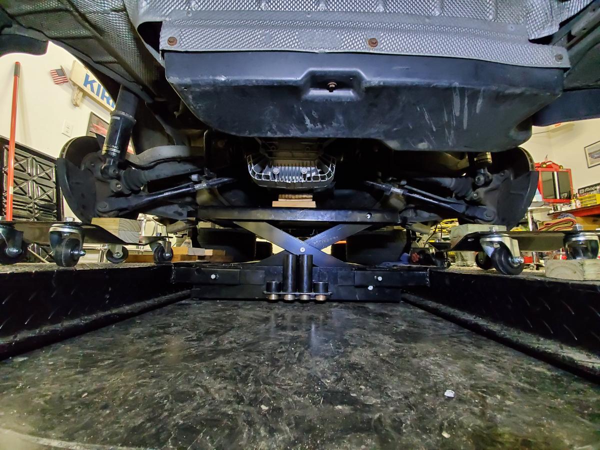

        Just making a running list, subframe hopefully dropping in about 10min, and I hope smoothly 🙏.
          May the Gods forever be in your favor my man. Good work, glad you could get back under the car.
            Do you know what fasteners were holding that piece on? I can see two of 51118174185 on the RealOEM diagram, but I see that there are three attachment points on each one.
              I was missing one of the two plastic rivets, it's uses two of those and then I had one of the heatshield screws securing the third hole.
              That's how it was since I have owned the car and it seemed correct to me.
