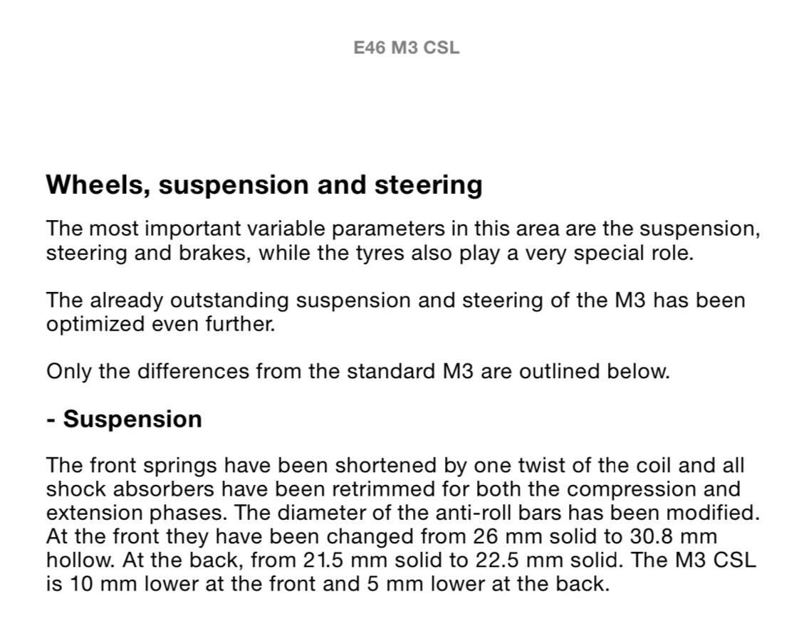

    First, the peanut gallery (me 🤪) is going to chime in with some commentary, so here goes:
    Stock Front Bar: 26 mm | CSL 30.8 mm Hollow | Hotchkis 30 mm Hollow
    Stock Rear Bar: 21.5 mm. | CSL 22.5 mm. | Hotchkis 25 mm
    Basic suspension 101 - Bigger rear bar equals more oversteer, and thicker front bar equals more understeer.
    My sled is fitted with CSL bars at both ends, and they are clamped in place with Power Flex poly sway bar bushes that does not give way to fingertip or thumbnail pressure, unlike the stock low density rubber bushes. For background, my sled is fitted with PSS10 coilovers, and the tires are Pirelli PZero PZ4s.
    On fast sweepers (on ramps/off ramps), I can feel the rear wanting to step out so careful and even throttle is required. On street corners, there is a bit of understeer that promotes stability if a bit too much entry speed is carried in, but trail braking (my preferred method), or a judicious throttle pedal stab will easily bring the rear axle around.
    The Hotchkis bar’s front thickness is .8mm less than a CSL bar; more importantly, the rear thickness is 2.5 mm greater. This means Hotchkis bars really want to make the car rotate, especially with 2.5 mm more meat on the rear bar. For me, I do not like tail happy handling sleds; it is way too spooky, and less forgiving of any red mist that one would introduce involuntarily into their driving. I like a smidge if understeer to keep the front end predictable/stable, while keeping the rear axle in check. Trail braking and throttle manipulation can be used to control the rear axle, in my opinion.
    One of the good qualities of the Hotchkis bars are that they are adjustable, this allows you to tailor your car’s handling to your taste/preference. If you find it enjoyable to tinker and experiment with your ride, I think the Hotchkis bars fit the bill.
    On a very basic suspension level though, those Hotchkis bars in my opinion have specs that strongly hint at dialing out any understeer, and increasing oversteer (just look at the added stiffening percentages of +70% and +105%). Whatever you do, I am confident that it will be the right choice for you. 🙃

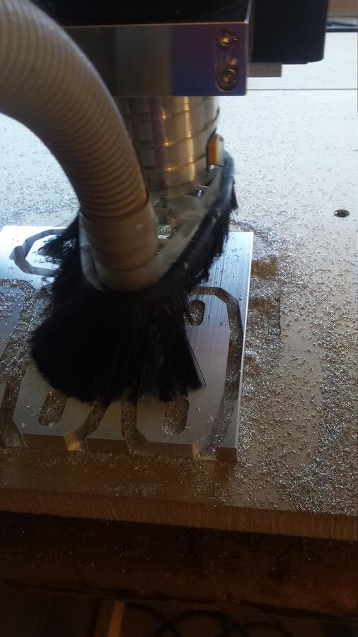

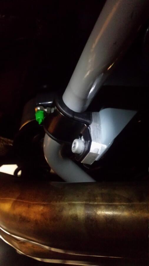

            If you do get a Hotchkis rear bar and you buy used, make sure it comes with the spacers for the bushings/brackets which mount to the rear subframe. Some of the early kits didn't ship with them, and they're needed to prevent contact with the suspension on even moderately (13") lowered cars. I inherited some bars with my first M3 purchase and ended up having to make a pair:
