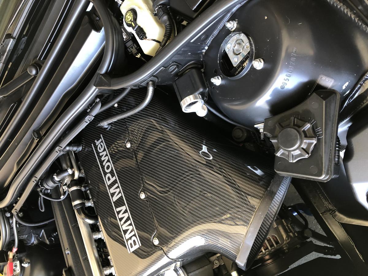

    When installing a CSL style Airbox I understand that the original air shut off valve can be reused rather than buying the csl air shut off valve?
    Is this correct? If so what needs to be modified?
    Why is the CSL one any different?
    Don't think the air valve is different, but the hose connects to the airbox in a different spot, and the hose is hard plastic and won't bend. So you need the CSL version or cut off the hard plastic line from the connector and swap the line for a silicone hose.

      EDIT: Whoops wrong tube...what COVID-19 said unless you want to buy the CSL version.
        Just cut a section and add rubber hose.
