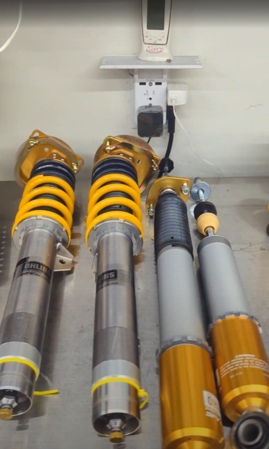

    Well, this is for my E90. R&T w/ GC street plates, 450lb eibachs front, 784lb (14kg) rear swifts. Still not as good as my MCS 1wnr on e46 😭. Wish I had not listened to those in the e9x world re: ohlins. They're good, even very good, but not great.
    I'm hoping a revalve gives me the rebound control I'm looking for, at full soft, so as not to introduce any extra compression from the damper.

      Does 3DM do anything additional to the Ohlins from Factory?
      I got my Ohlins Dedicated Track from Tirerack. I love them. But you are on point, jarring on the street but at Sebring with the bumps it SOAKS it all up well. I have it set a few clicks below middle
      I think they just take the standard R&T DFV dampers and revalve them for stiffer springs, then add the camber plates, shock mounts, etc.
      Curious if they ‘beef up’ anything internally…piston, etc. though I doubt it.
        Curious if they 'beef up' anything internally…piston, etc. though I doubt it.
        One of the main things he does is RTR, so you receive them and they're ready for install. He offers a specific 3DM track setup, I believe Shariq runs this.
        No need to beef anything up, just change up valve stack if anything

          You mean the advanced track day kit from Öhlins? On those TTX shocks you can upgrade from 2-way to 4-way.
          I have dedicated track ohlins directly from Ohlins I believe, I bought them off Tirerack.com

            I reached out to 3DM and the pricing for converting the R&T to DT is quite reasonable. They also said they could convert the rears to a true coilover. I have everything CMP sold for the RACP in 2019 (6 point brace, 2x4 beam, etc.) and confirmed with Cayn @ CMP that I'd have no issues running a true rear coilover. Given this, is going true rear the way to go?
