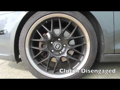

    My phone wasn't picking up the sound very well so I have this video as a good comparison.
