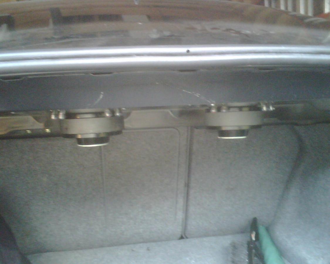

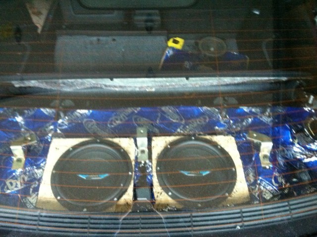

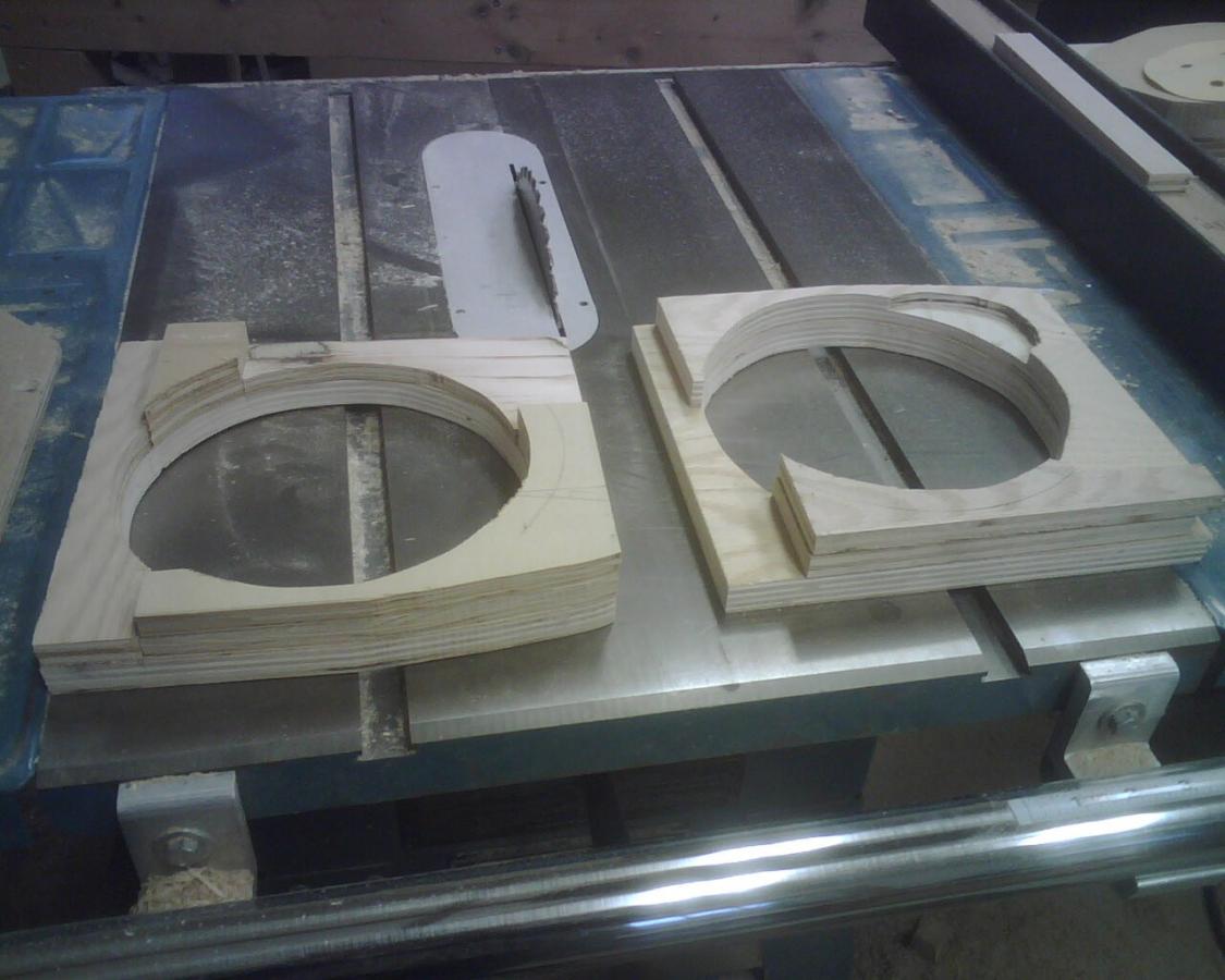

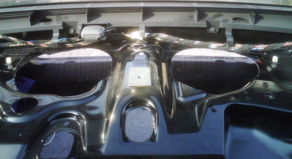

        Takes a little effort, but enlarging the factory holes, mounting some baffles, and dropping a couple freeair/IB 8" subs provides great bottom end with no loss in trunk space (compared to the factory HK sub)
