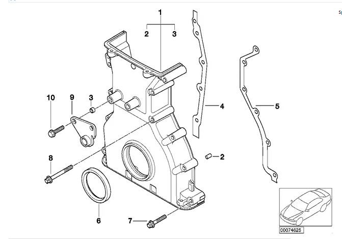

              Also based on this exploded view of the timing cover, i suspect its definitely the front main seal. Unless an oil pan gasket can also be to blame here as well?

                  I don't think it's the oil pan gasket, as there is oil above it.
                  When my front main seal was leaking, the oil would get onto the harmonic balancer and get flung everywhere. The entire front of my engine was coated in oil. Actually, it was so bad that I had the aux belt shift and shred itself while driving one day. If only one side of your engine is oily, then I don't think it's the front main seal. Grab a mirror and look behind the harmonic balancer, should be pretty obvious if there's a leak from that seal.
