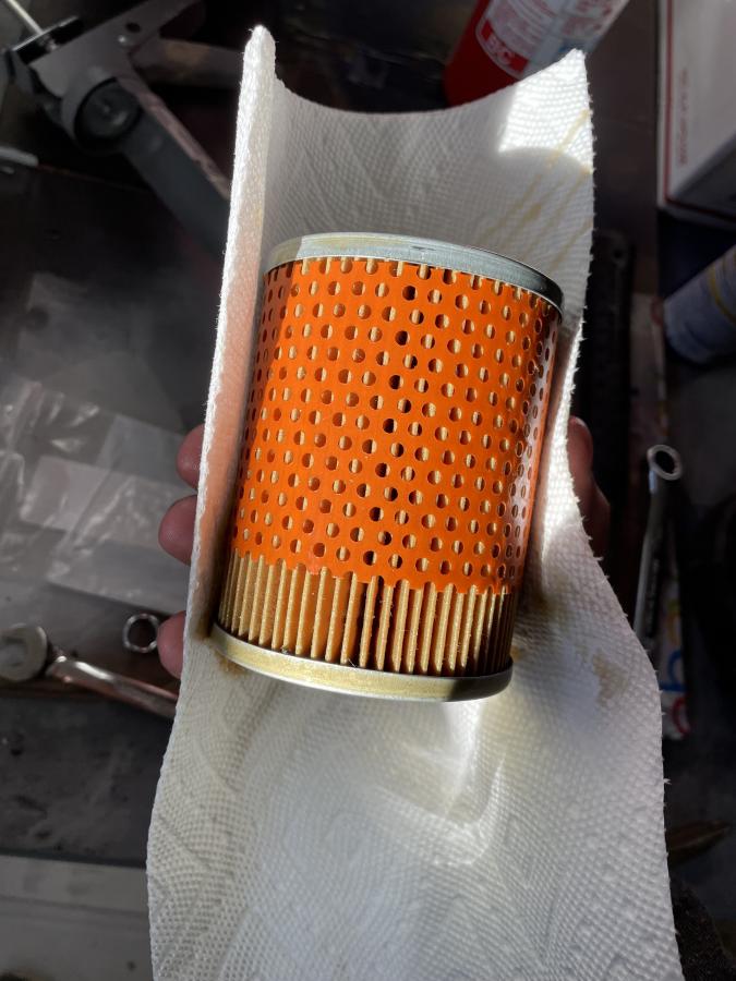

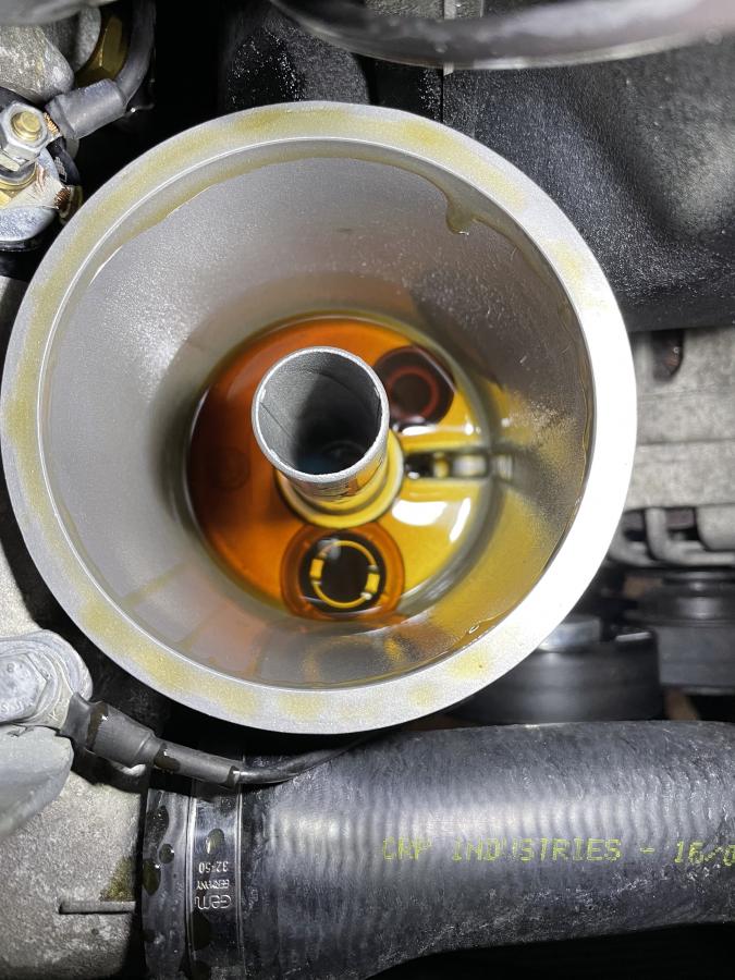

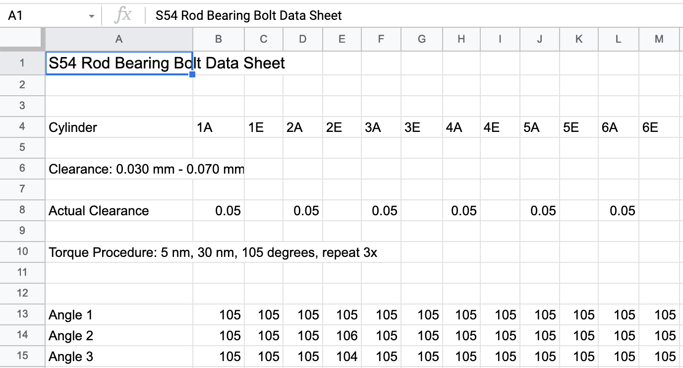

    I've looked at both the oil filter and vanos filter and there doesn't appear to be any metal in either, and the oil I drained looked very clean. I recorded all my bearing clearances and angle torques in a spreadsheet when I did the bearings and everything looked good there, so I'm really hoping there's nothing wrong with the bearings. I replaced all the major "while you're in theres" including cam bolts, timing chain guide, tensioner, as well as any gaskets I could get to.
