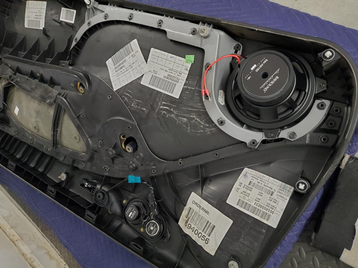

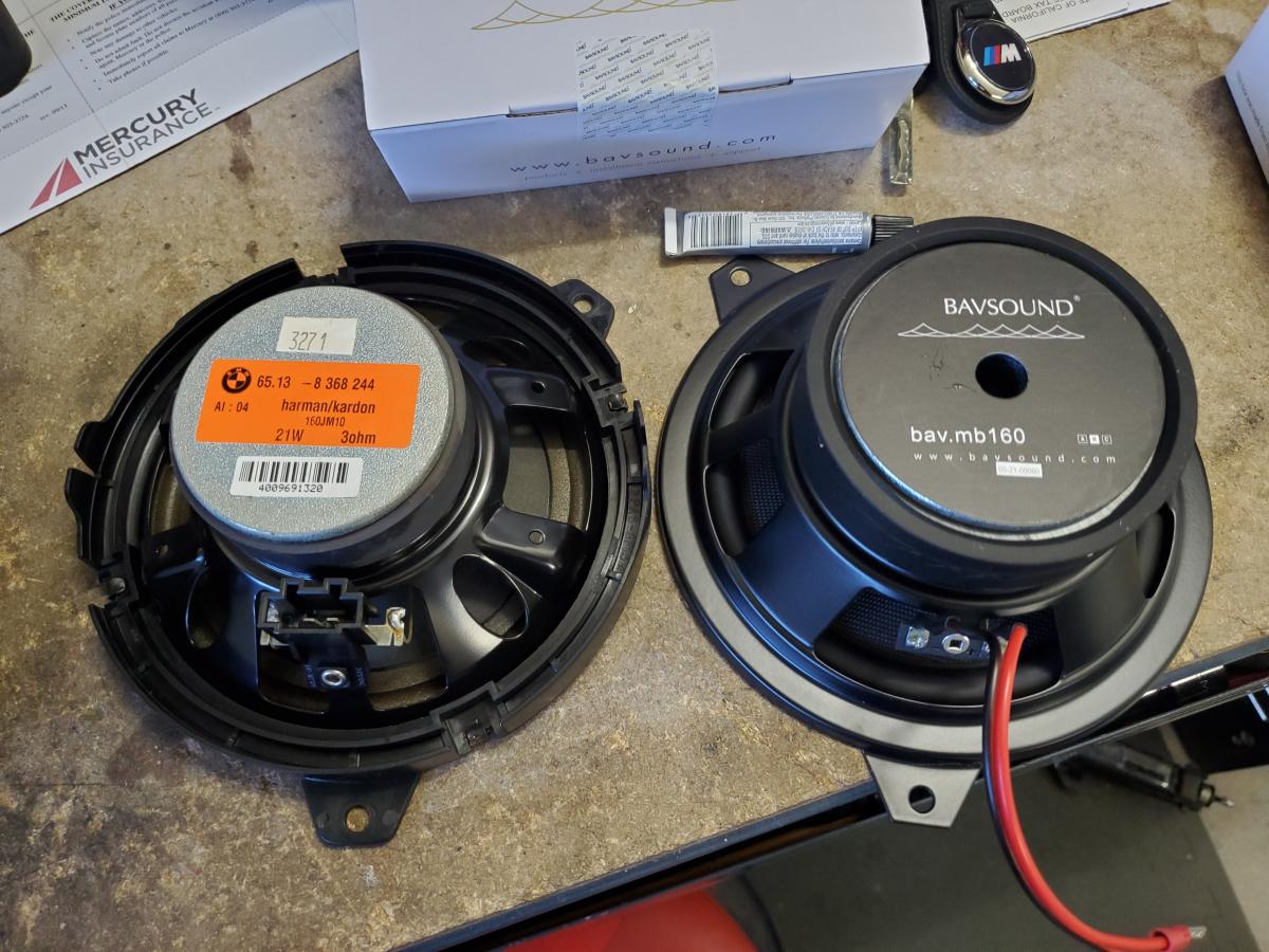

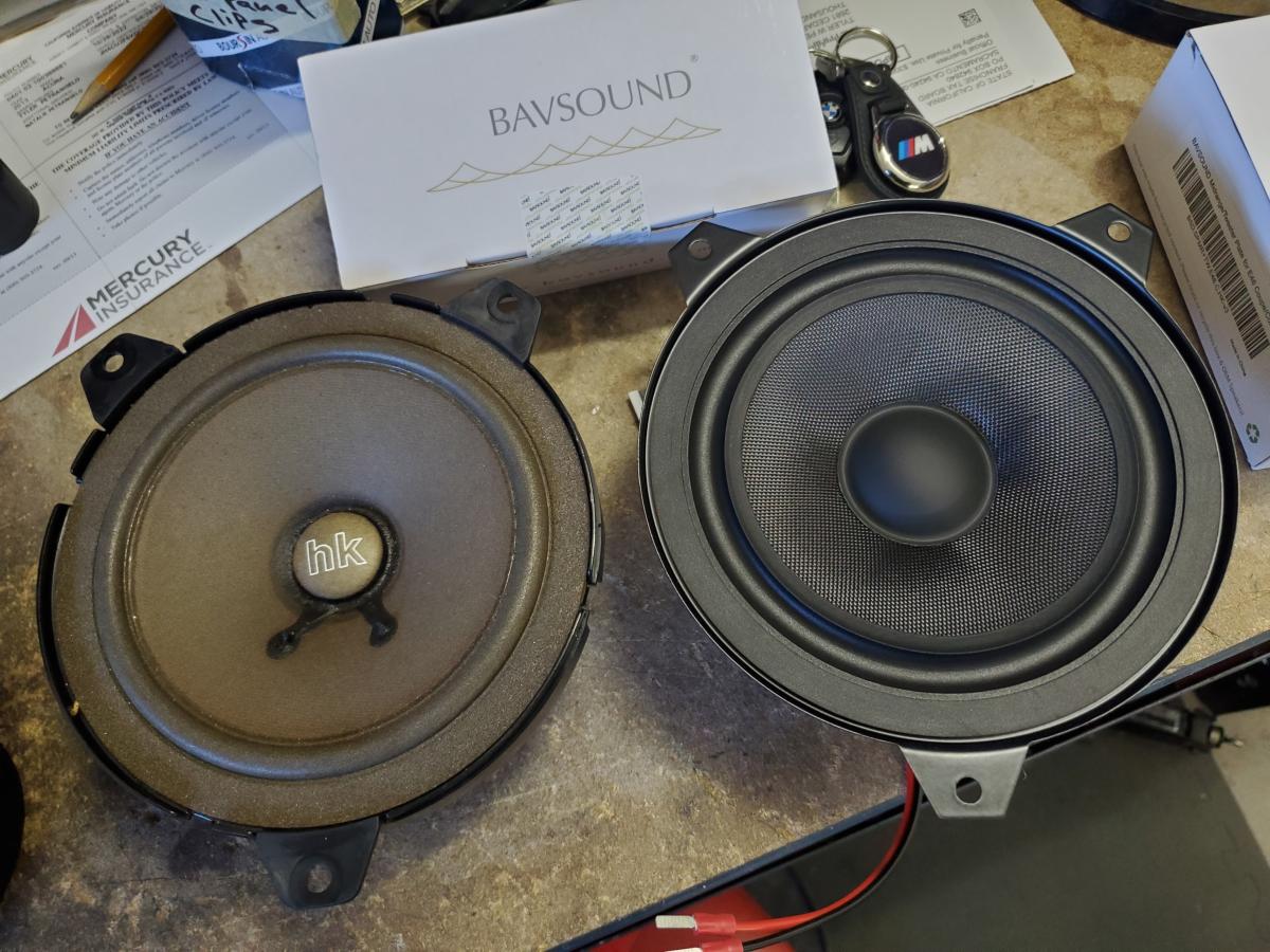

Installed some Bavsound in a coupe recently. The plug and play aspect (minus the rear 2") is very nice, and I see the appeal, making it easier to swallow the price of the kit. The speakers themselves are like any decent speakers - speaker technology has not really changed a whole lot like other electrified tech (perhaps more in the fitment of them due to neodynium versus ferrous magnets).
I say that not to disparage the speakers, but to calm people's expectations - they are not magic. You need an amplifier.
That said, they're good, and you may have at least some factory speakers in poor condition like this fellow member did:
Cone material looks to be kevlar or some sort of non paper but also non metallic construction. I prefer stiffer like carbon treated paper, for a crisper response (high guitar, vocal, top range of the snap of the drums). These seems like they'll have a warmer response, which isn't the end of the world - better than the too cold of metal or muddled response of the cheap poly/synthetics imo. Again though, nothing will improve the sound like a proper amplifier, esp class A/B if you can/want to fit it. I'm not sure if the factory amp, even HK, can power them enough to truly judge the fidelity of these drivers.
Install into the door panels and rear couldn't be easier.
I will say it sounded better when I listened to an MP3 file (not known for bass response as the compression is mostly the low end data) after insall, though I also installed an Avin 4 unit at the same time, so not sure how much was the speakers or source, but I defintly noticed more response on the lower end from the front woofers. I can't say for certain if the factory HK speakers were functioning properly though, they looked fine so I would assume so.

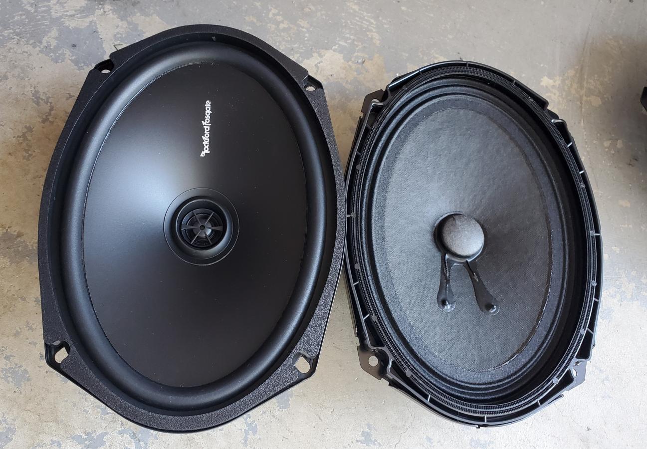

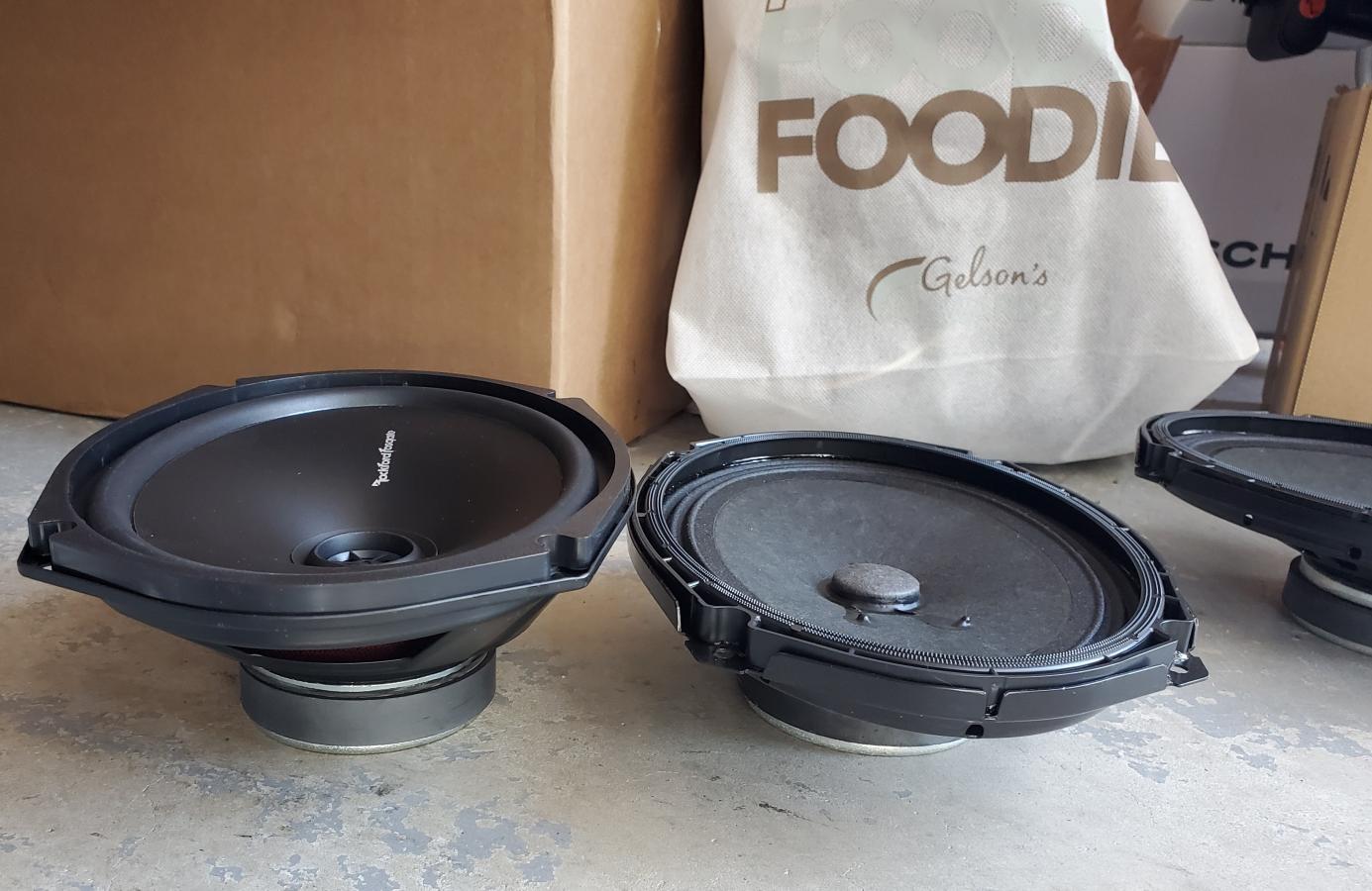

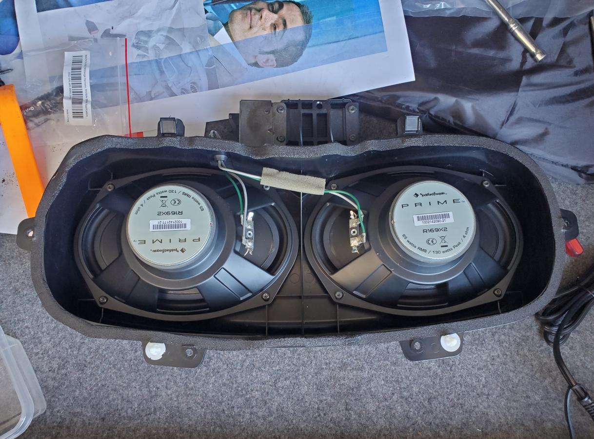

Owner also wanted to do what Gary (wolfn8tor) did with the HK subs, putting in RFs. The units were pretty nice, I can see the appeal here as well, but these were really disapointing. Could barely hear them (could be a ohms issue), and they didn't move any air. Then I realized why - have you seen the HK subs' amplifier? It's the size of a candy bar lol! The audacity to call these "subs" lol. Do yourself a favor and power them properly, or remove them to save weight, because they're only pulling your sound image backwards, and certainly not playing any non directional freq (sub 80hz). Put in a round 8" or square 10" into the ski pass in infinite baffle, or a 10/12" in a sealed/ported box in the boot imo.
Install's not bad if you're okay trimming the RF's plastic surround.
You can see the RF's should be capable of some good midbass with like 50-100watts. Maybe the amp was expecting 2ohm? These are 4 ohm.

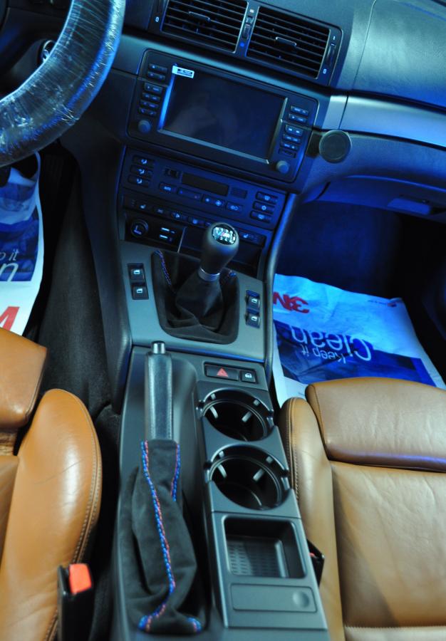

The avin unit, at least in its fit/finish, was impressive. Looks at home. Can bus didn't work (steering wheel controls). Also put in the dynavin console/ashtray replacement/usb.
Owner got all new goodies, euro tray/arm rest delete, trim, boots. Looks fantastic imo, if you want this type of double dinn solution.

The factory amp can power the BavSound speakers but you need to turn it up a bit, which starts to "color" the source sound. +1 that amps are better if not necessary.

I doubt these bavsound speakers have much of that material improvement in them that you speak of. My point was to not expect bavsound to be something special or have revolutionary tech. They're middle of the road drivers, but that even middle of the road drivers can sound good with a musical aftermarket amp.
To be fair though, my experience with factory amp in E46 is non HK; perhaps HK is decent. I don't know the output voltage, only my E90's.Last edited by Tbonem3; 02-28-2023, 03:12 PM.DD: /// 2011.5 Jerez/bamboo E90 M3 · DCT · Slicktop · Instagram
