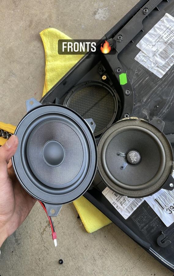

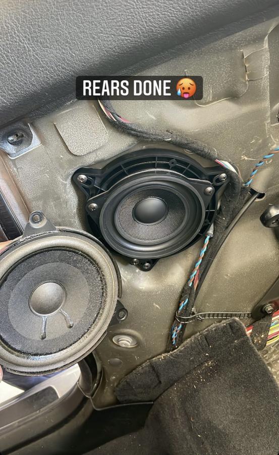

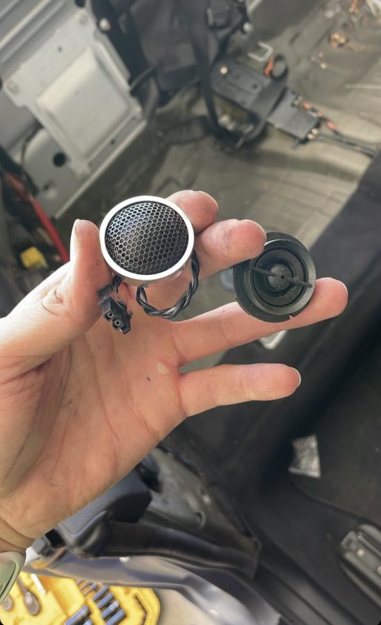

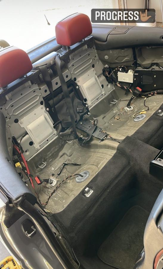

    I have to say, I was very skeptical installing this setup due to the fact wiring is something I am not really familiar with and was quite worried about taking my whole rear interior out, but it was a breeze of a installation. Instructions were really easy to understand and the overall quality of the product made it a fun install. Regarding the product, I absolutely love it, I originally had the factory Harman Kardon setup but wanted a bit more base and with a bit more clear sound and they delivered everything I wanted. Overall I am very pleased with the install and up next is a new head unit!

                        For anybody thinking of ordering this kit, be sure to carefully guide the door speaker wiring.
                        I had a rear speaker wire coincidentally hang exactly where one of the screws to reinstall the panel fastened. After a month of driving, the screw had severed the wire and I mysteriously had no audio. Took a lot of misdiagnosing before tearing the car up and realizing what had happened!
