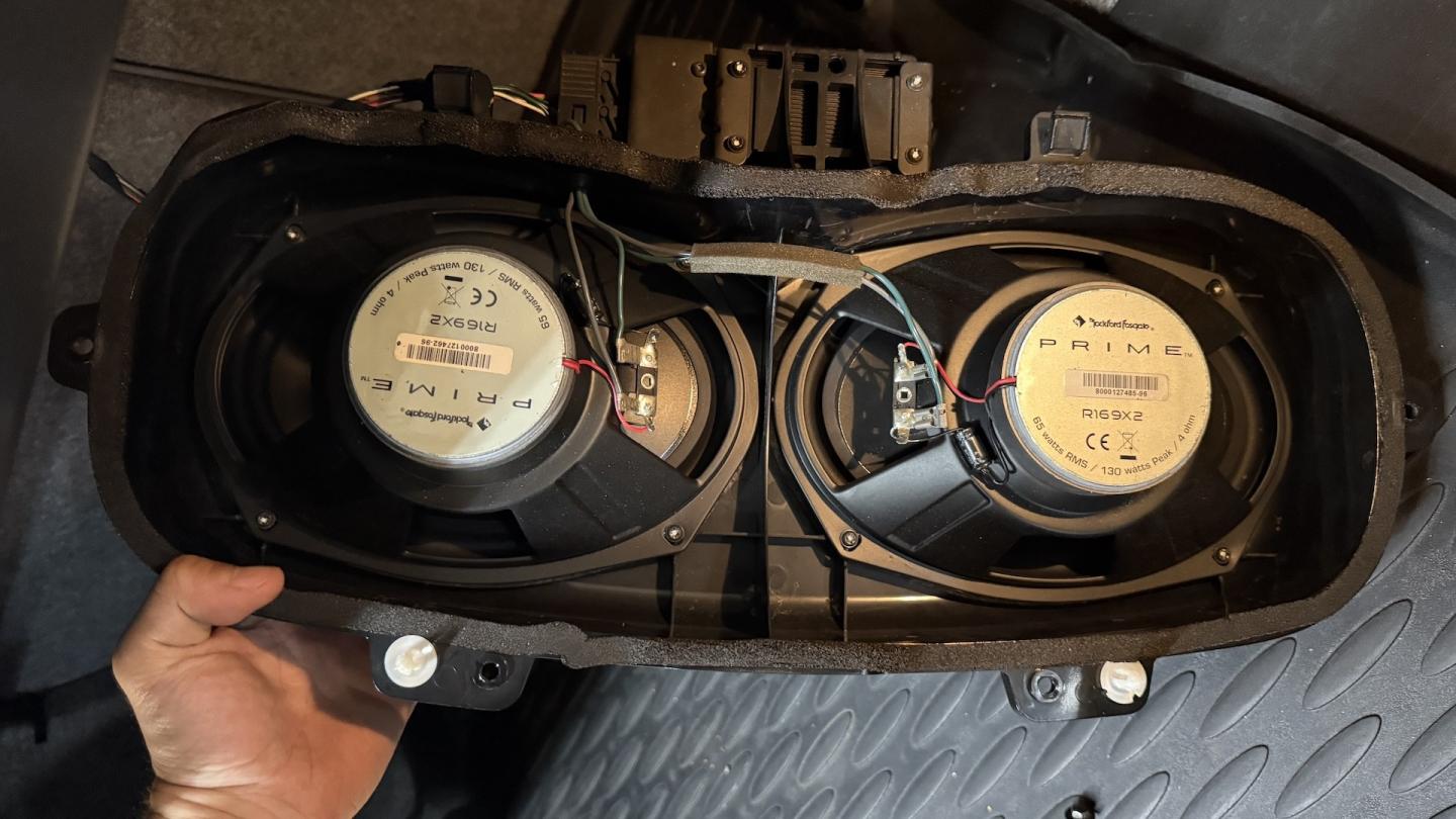

                              Following up here - I did the Bavsound and Rockford fosgate 6x9 upgrade: They sound awesome!!! My setup is: Avin Avant 4, factory radio was non-nav, and nothing else.
                              Now I'm facing the following problem: The Harmon Kardon carrier is vibrating like hell when turning up the bass. I have the tennis balls still shoved up and under the deck as always, and have verified that it is this actual box: I took the box out while the car was on, and played music with it out and still connected. The box itself is rattling like crazy.
                              Anyone have a fix for this? I'm thinking to by some dynamat and just stick some pieces all around the enclosure but thought to check to see who solved this already as I know this has got to be a thing when replacing the 6x9's
                                Interesting that the box itself is what's causing the rattling. Have you tried unplugging one speaker at a time to see if the rattle still exists? If I recall correctly, the box is one piece of plastic so not sure what could be rattling. Try holding the box in your hands and see if you can feel the spot that's rattling. If you hold it tight and the rattle stops, that's where you should place the dynamat.
