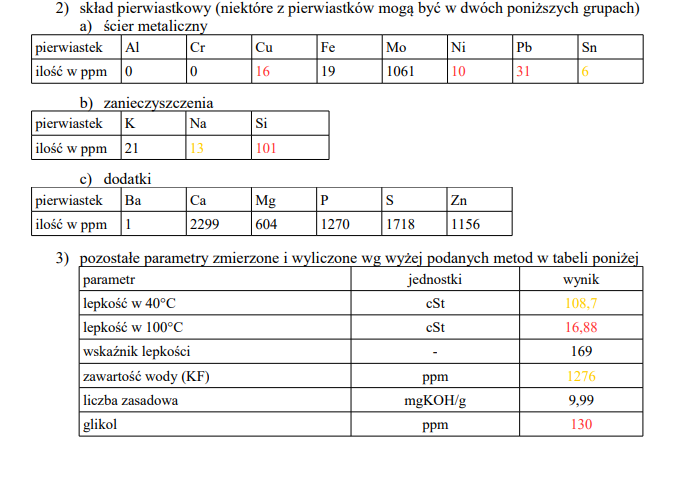

    ive got a report from oil analisys and unfortunatly i doesnt have good news for me
    Oil is 10w60 changed 2kmiles during rod bearing job
    and now ive got info there is high levels of wather and cooland (glikol) in the oil, but i have mesured the compresion and was 13bar on all cylinders.
    is it possible that head gasket failed in a way that is leaking the coolant to the oil ( from what i know they mostly fail between the cylinders)

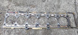

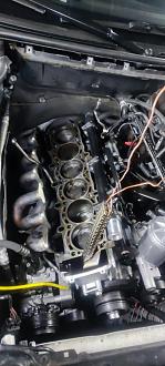

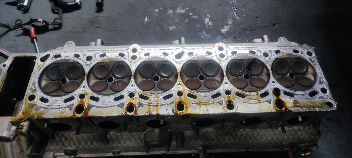

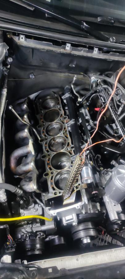

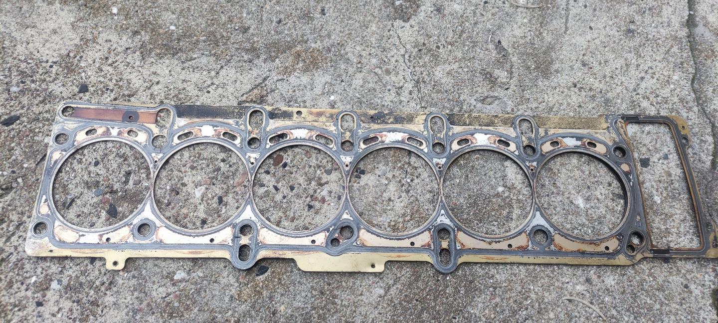

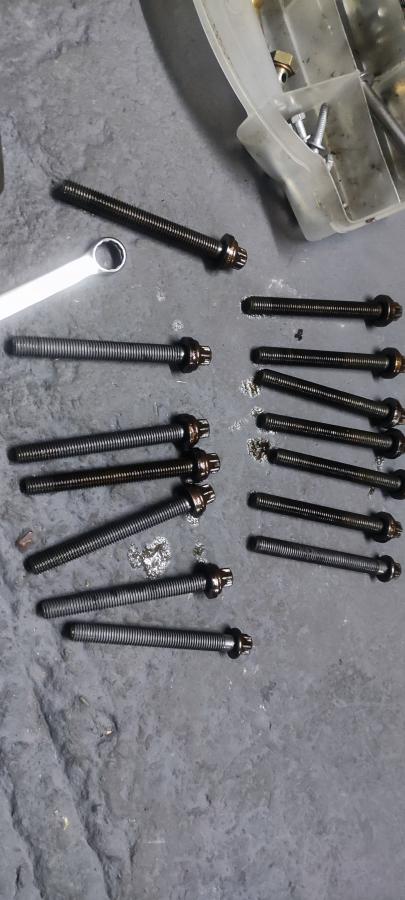

              ok did the job today
              gasket seams to be ok, blok is ok no cracks in the cylinder walls, some carbon buildup on the pistons
              only think i felt that some of the bolts felt looser on the head, and few was dry, rest of he was soaked in oil
              going tomorow to the machine shop for testing and rebuild the head

                it does not see bad TBH, like you say, maybe a loose bolt. head skim and clean with new gasket and bolts should be all you need. Is ARP bolts a good upgrade here for better clamping force retention over time?
                            yeah if the head is ok, then i will order to change valve seals, and clean up everything with valve reseating
                            does the arp torque sekuence is diferent then oem bolts?
