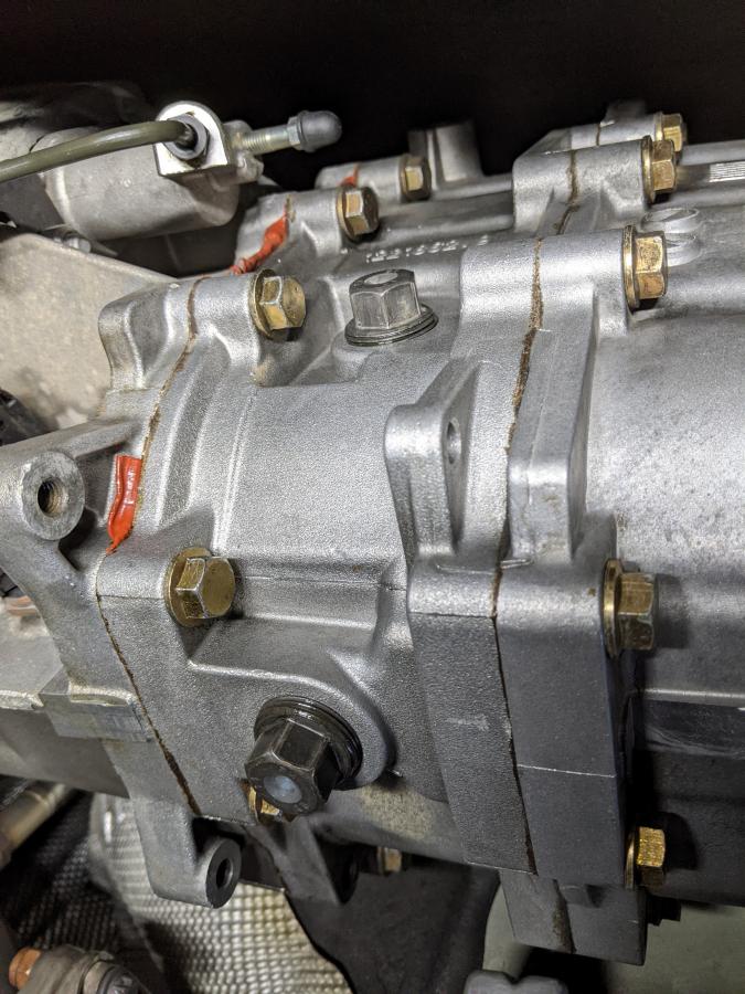

    I noticed oil slowly seeping out of the fill and drain plug from the transmission. I've tightened the bolts as much as I could from under the car and it still happens throughout a week's time while the car sits idle. I've cleaned the area multiple times to confirm it was dry by wiping away the wetness from the exposed threads.
    A search from the internet revealed an updated drain plug from the E39M thread, same plug as E46M, but I don't recall this being an E46M problem.
    Found the attached pdf from the E39 thread, but it only appears on the early model E46s.
    Wanted to throw this out there before I get new plugs and test.

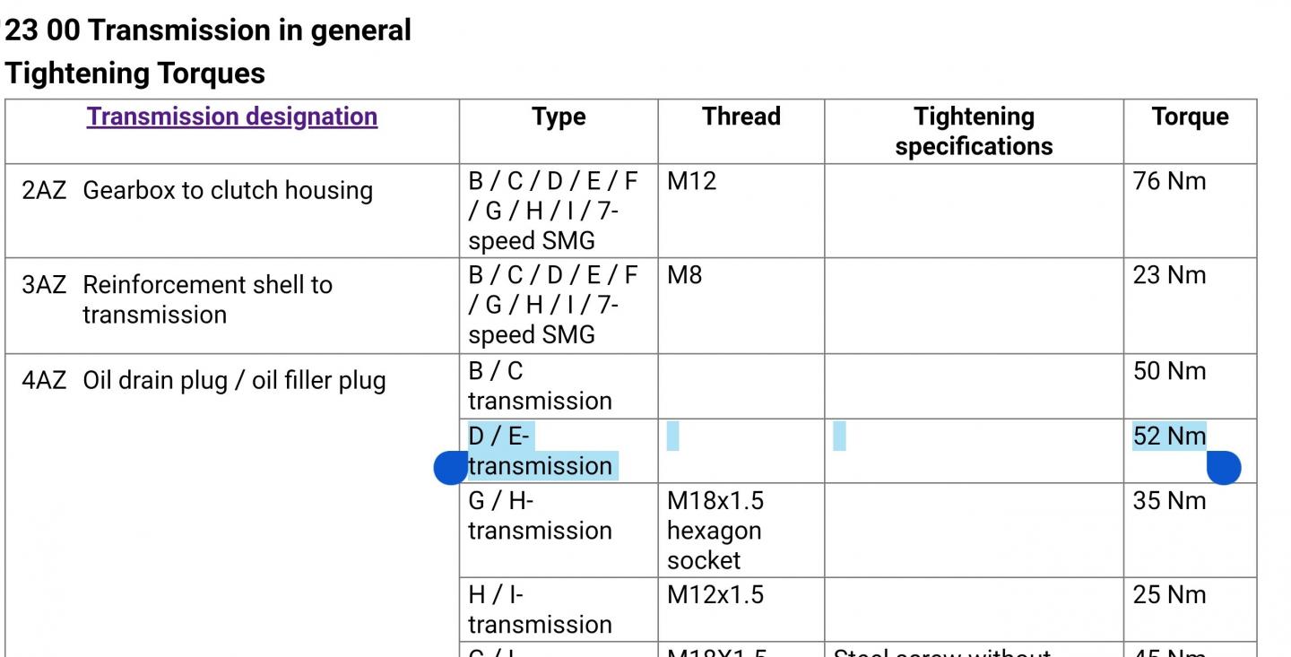

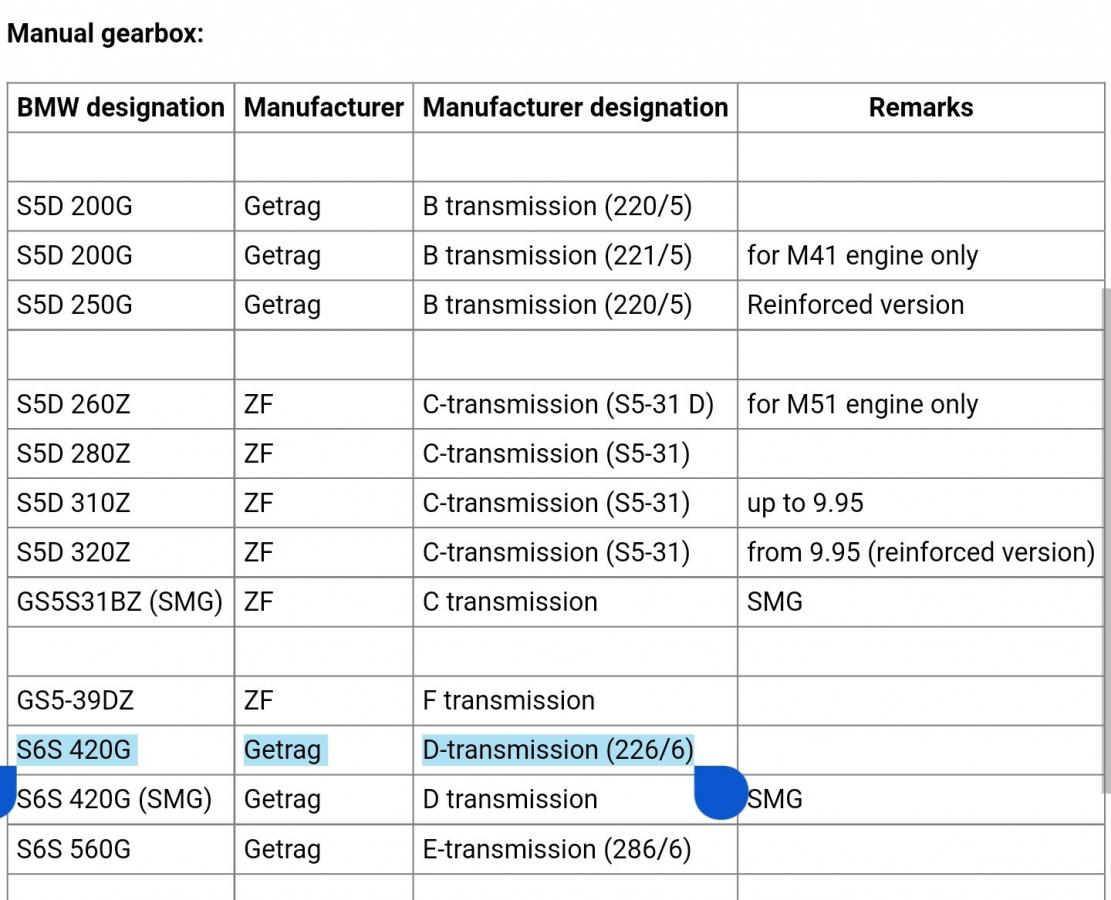

                Is it 37 or 38 ft-lb? This site says 37.
                  Was looking up procedure to fill and torque spec, but looks like you answered it. Thx bud!
                  I’d guess it’s 51 Nm, which is somewhere between 37 and 38 ft lbs, and you are seeing people round it differently.
                    TIS says 52 Nm, so 38.35 ft-lb if you want to be super precise
