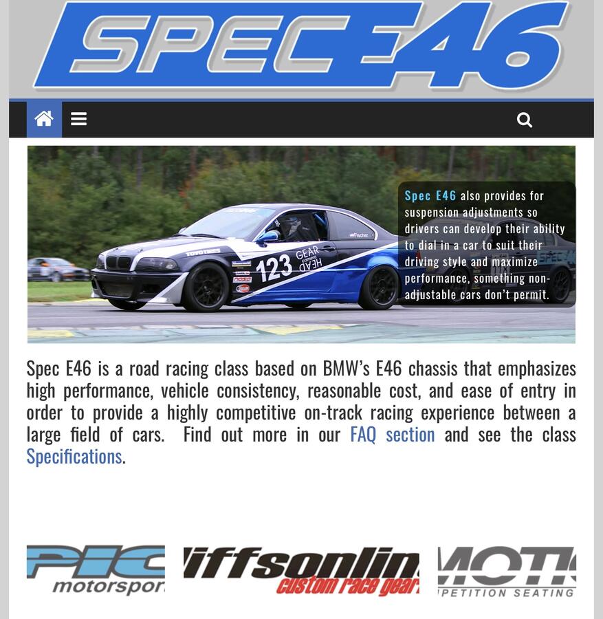

            You’re in Sacramento... I just noticed that 🥴. Valley Motorwerks is a builder of cars for the following road race class:
ID:	19407 Dave Trux, the Owner, is a good fella. His info:
            11403 White Rock Road
            Rancho Cordova, CA 95742
            (916) 636-9526
            [email protected]
            Perhaps contact him; convey to him what you’d like and pick his mind. If you like what you hear, Dave being local might serve you well.
