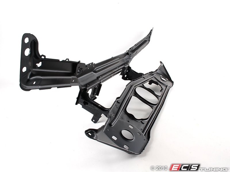

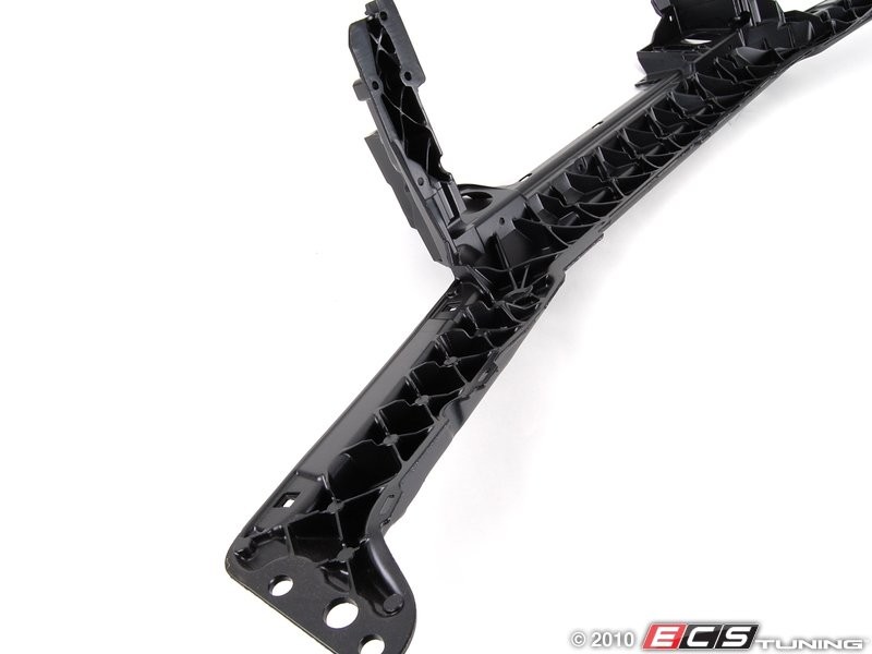

    The radiator support from a convertible seems to be more reinforced than the standard stamped steel one. It ties together the two engine-support arms as well as the wheel arch sheet metal. Also, ~1.3kg heavier.
    Has anyone installed this piece, and was it noticeable?
    Standard (link):
    Convertible (link):
    I recently parted out a convertible, and it definitely had the core support that you are calling the “standard” one.
      Same observation here.
        That 2nd part is the non-M convertible part #
          https://www.realoem.com/bmw/enUS/sho...diagId=51_4115
          Cross listed for all convertibles, including m3. (link).
            Those lists aren't always perfect:
              I fitted one to my M3, didn't notice a difference(I don't track me car) but it is way more rigid so it by theory it should firm things up.
