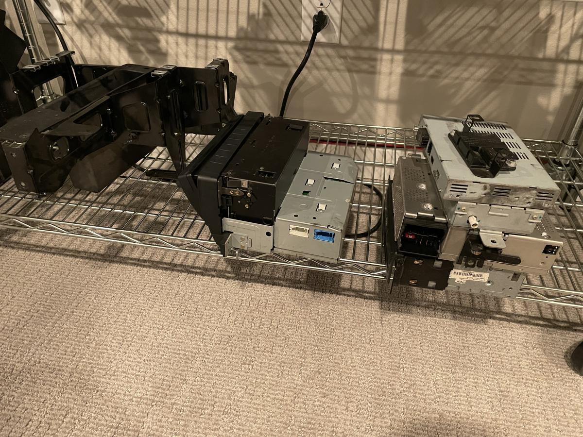

                when i did my nav delete just the trunk components and speakers added up to about 26 pounds, so a decent amount of weight savings to be had

                  That's kind of what I did-- I pulled out every stock stereo component and the stock wiring harness, swapped the OE Nav head unit for an Avin, and plugged my 4 speakers (which I selected by their weight) directly into the Avin, using its' internal amplifier. The modules/wiring/brackets totaled almost 50 lbs, and I gained a bunch of functionality (critically, wireless carplay, but also including track functionality-- I can monitor tire temps/pressures, or add extra gauges, or pull codes, etc, using the Avin).
                  All I've really lost is bass-- the mids/highs sound dramatically better than they ever did with the stock stereo. I have a stealthbox and tiny (2 lb) amp I could install, if I wanted the bass, also, but care about the weight savings more than the bass (especially since what I listen to is podcasts, 99% of the time).
                      I must be mis-remembering then... That was a long time ago . I recall the HK sub/amp being the main contributor.
                        The stock stereo harness is pretty beefy— prewired for every possible option the car could have had. Removing that is pretty significant savings.
