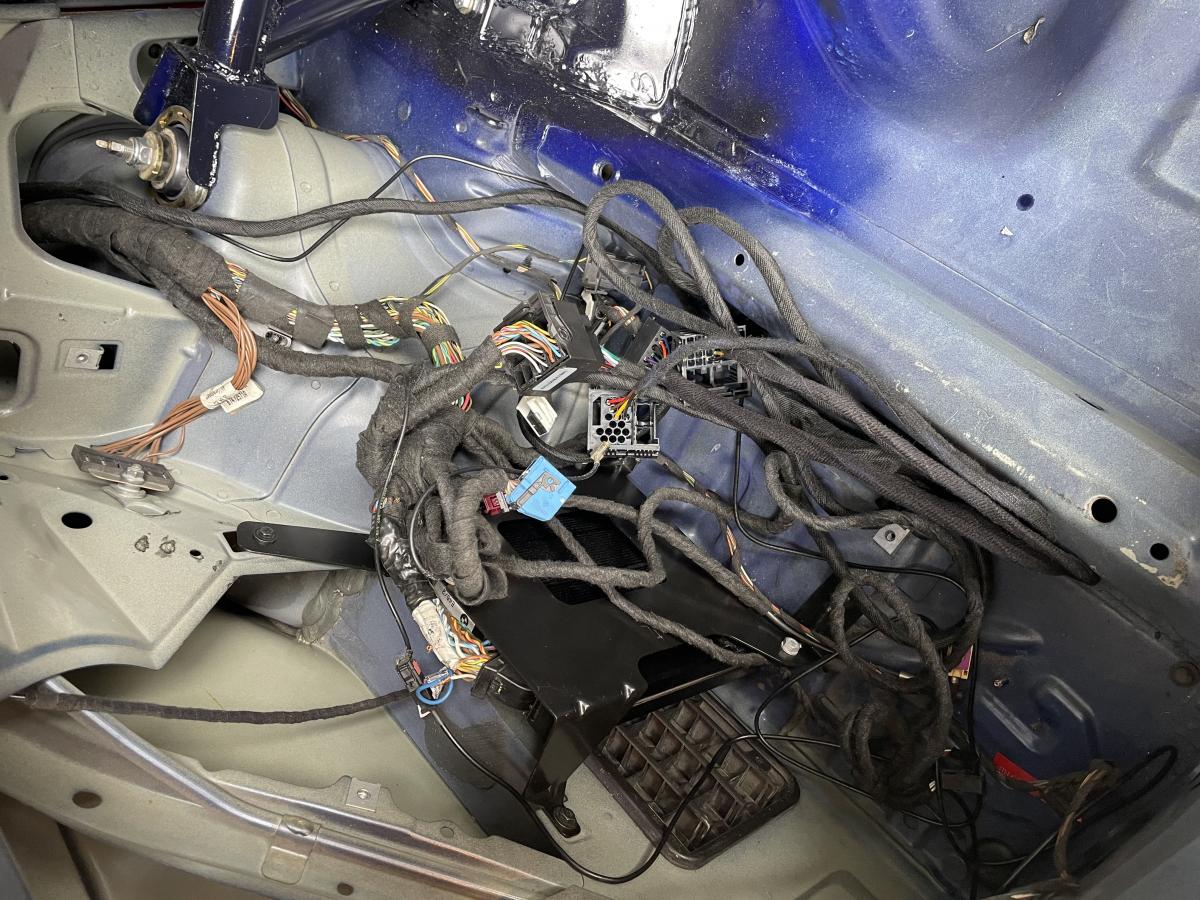

      As I mentioned in the other thread, if you just want to mount the amp in the trunk, you can get part 65128370926. Ignore the mess of wires. It’s been difficult to locate a coupe HK non-nav harness.
