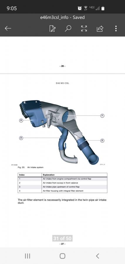

    Current:
    I had a photograph (I think from cslregister) from the perspective of the backside of the bumper with the bumper off the car and it is was quite clear how it all came together, I'll keep looking.

      That's an interesting diagram there. Thanks for sharing. That one does indicate where the 3 pieces I do have go, but what's alluding me is what the flexible hose does and how it fits into all of that. It's not even shown in this photo. Seems it likely feeds that lower air hole on the bottom side where it joins with the intake pipe #3.
      Would love to see that photo you mention!

            Those diagrams are from the CSL aftersales training document. I've attached it here. Pages 25-30 describe the intake system.
            The bendy duct just acts as a muffler. It's not entirely necessary to have, as its only purpose is to muffle intake noise at low rpm. The other parts are more important, as they funnel cold air to the intake.

                Really interesting. Kind of strange how that flexible hose just kind of hangs there. The narrow portion just tucking into the bumper by the hole. So safe to say I can kind of skip that....
                Current:
                  Yep, doesn't really serve a purpose besides muffling
