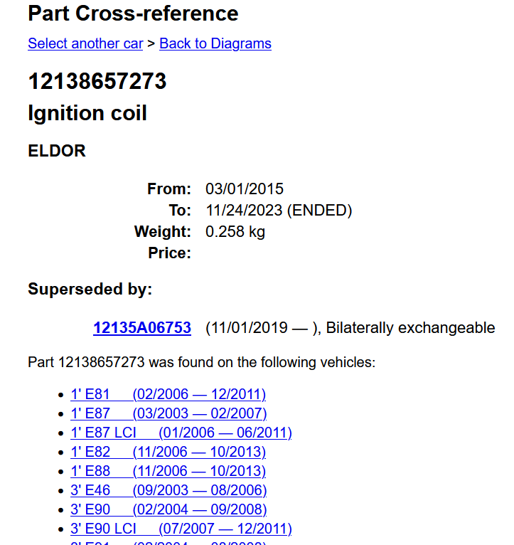

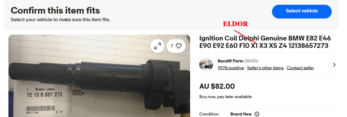

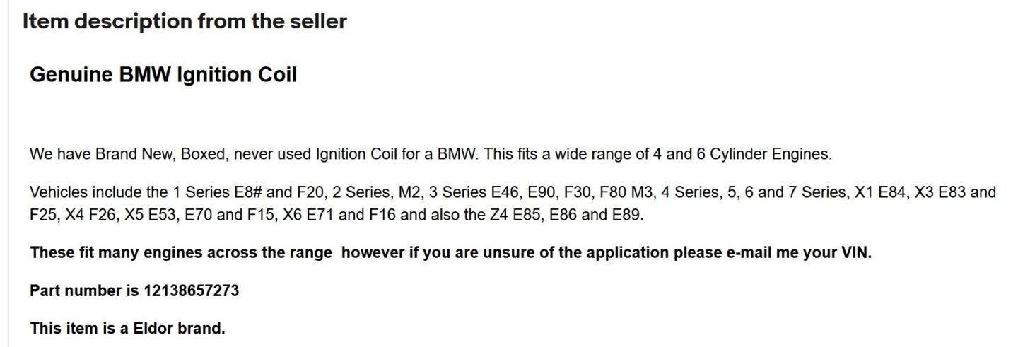

          part number for 273 ELDOR is NLA
          I found NOS here in Australia if anyone still wants to run ELDOR from a BMW box
          Is the ELDOR part number still the same ? or have they changed ?

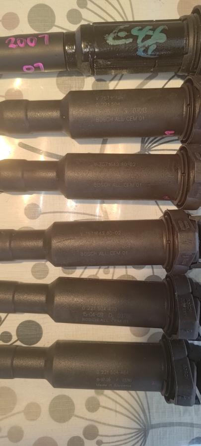

            Found the Jelly Bean Coils on mine, Wish i payed more attention the last 5 times i had them out comp testing and doing the head gasket
            Found a old 260 coil from 2007 with E46 on it (must of been from a junk yard )
            Some Bosch 08s
            A Bosch 2015
            A Bosch 2019
            Seeing this is some serious motivation to swap them out

              Waking up - FCP sells that Eldor part number coil, but does not show it as fitting the S54: https://www.fcpeuro.com/products/bmw...657273#fitment
                #37
                It will fit. The same part was used across a lot of different platforms beginning 2003. LCI E46 330s changes to this coil.

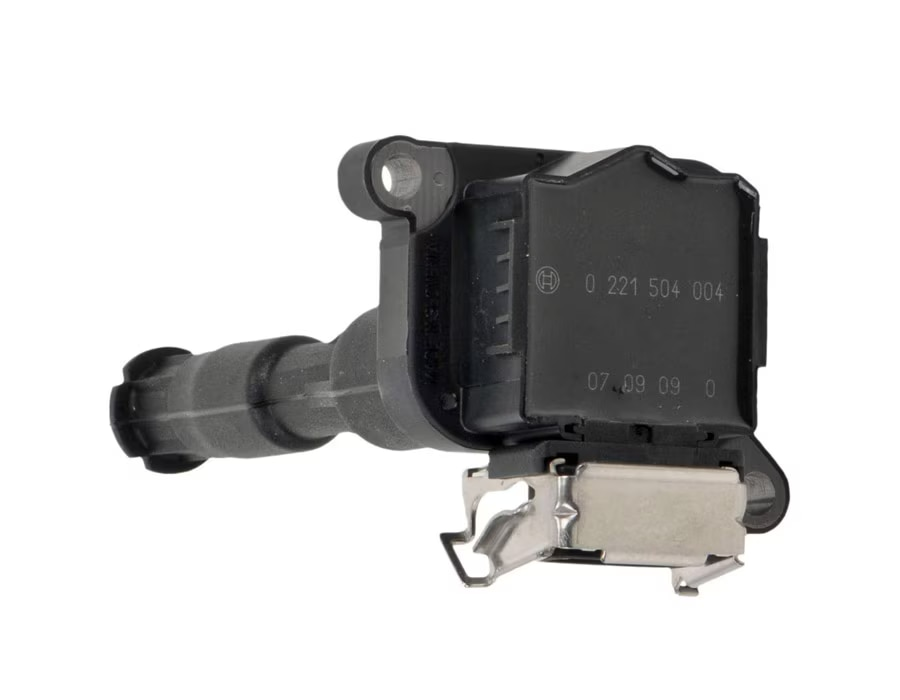

                    These are the best coils for E46 cars. Unfortunately the M3 can't use them. They were used on early cars.
                        I may need new coils... link to the NOS Eldor coils you speak of?
