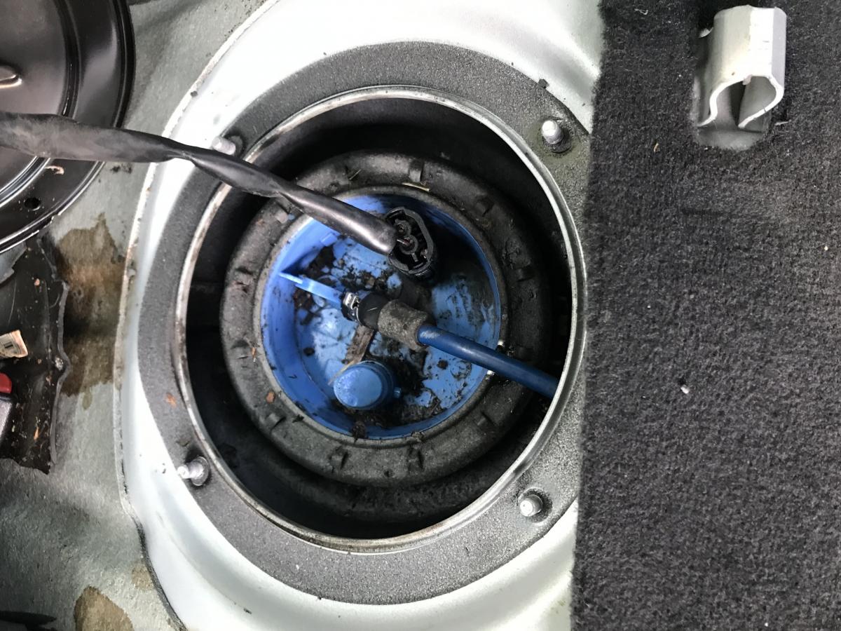

    As the title states, I filled up the car this morning and noticed afterwards I have a small gas leak coming from the drivers side in front of the rear tire. I pulled the rear seat and removed the fuel level sending unit cover on the drivers side and the little cavity was full of gas and old debris from a mouse nest. I soaked up the gas and started the car and there is no sign of gas leaking in the area that was full of gas.
    Is it possible the seal is bad for the fuel level sending unit?
    I only took a pic after soaking up the fuel.

    A friend had a similar thing happen and it was the blue nipple on the bottom of pic 2. It had a small hole.

      Probably one of the fuel lines is corroded and split. If its the one in pic 2 you may need to lower the tank slightly to feed it through if you can't snake it up past the frame rail.

        It's odd because it only did this after filling it all the way up. After soaking up the gas on top of the fuel sending unit I don't see a leak while it is running. I think the seal is bad in the fuel sending unit. New unit is around $150. I may drive it and see if it starts leaking again.
          Found the issue, hard to tell but in the pic you can see there are some nibble marks on the top of the cylindrical piece with the slash face. This resulted in a few pin holes which leak when the tank is full. This is what I get for not driving the car enough.
            Are you talking about the blue cylinder shaped protrusion that is on the bottom of the pic? Opposite the electrical connector?
            I had a mouse nest in the same spot on mine at one point. They chewed thru the wiring for the electrical connector and I had to repair it. Seems to be Park Avenue real estate for mice.
              That would be it! I agree lol Mice must love that little spot. Particularly in North Carolina
