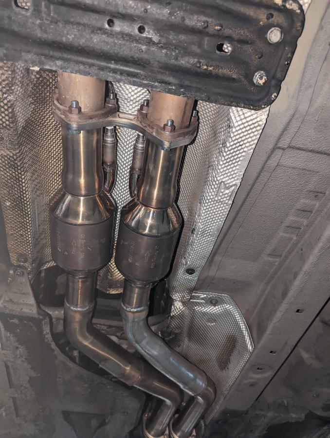

    I recently had a Fabspeed sect 1 installed and was warned by the shop who did it that it was an extremely tight fit. Now, after a few hundred miles, it's rubbing something. Especially at idle. If I coast forward a little, it will stop.
    I am taking it back to the shop soon, but am hoping others may have ideas for how to keep the piping where it belongs 🙇‍♂️

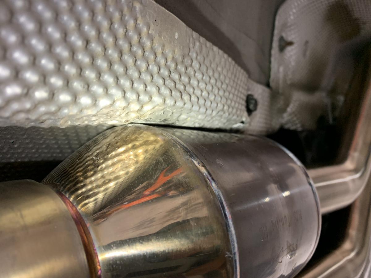

        tl;dr: the Fabspeed pipe doesn't work well with a Euro header (and presumably US headers). The Fabspeed isn't able to get far enough towards the driver's side, so the cat ends up rubbing the headshield.

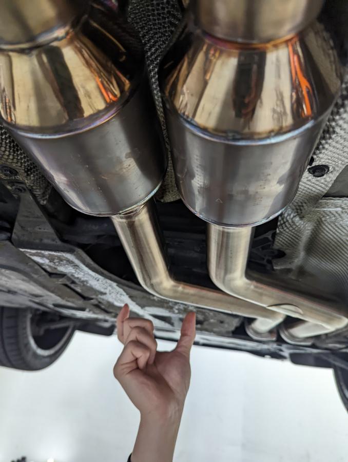

        I ended up paying a muffler shop to extend the Fabspeed piece a little, which nicely centered everything up. Still...total PITA.
        BEFORE:

        RUBBING HEAT SHIELD:

        AFTER EXHAUST SHOP WORK:
