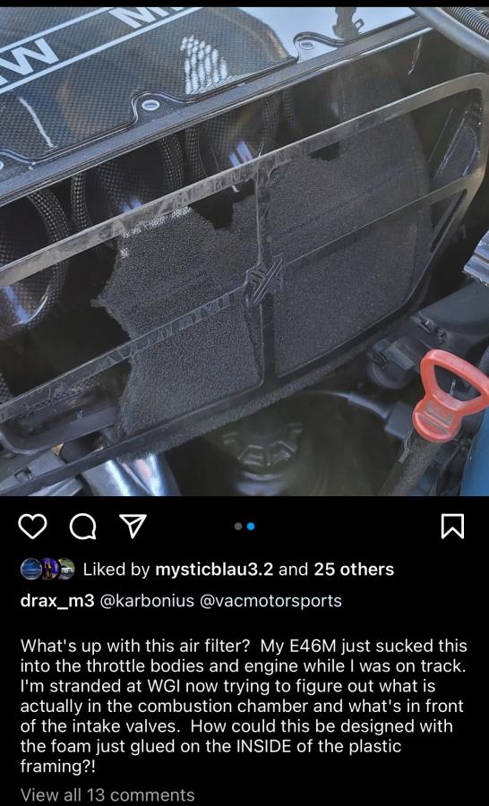

          karb filters seem to have a small problem.

            Was just about to post this. Real bummer for that guy. Filter looks different than the ITG one Karb also has a branded version of.
              It was made by Pipercross in the UK and the design looked questionable when Karb first introduced it.
              At least the other filter made by ITG was a bit more durable, but even those foam filters could deteriorate after a few years.

                Same issue for me, I use the CSL filter now
                  I thankfully bought another BMW OE CSL air filter so I've got another on hand.
                  I'll need to give a gentle wash. I bet there's lots of crap in there from all the fires we had in CA last year.

                    Wow. This thread reminded me to order a BMC/OE like I've been meaning to for a while. My Karb/ITG is a few years old now with no issues but extra glad to be replacing it. IND shipped super quickly, showed up in a couple days. $150 is a pretty terrible price for an air filter though, kind of worried about long term pricing and availability on these.

                            Just changed out my ~2018 timeframe Karb air filter for the BMC from IND (came in a BMW box with BMW part number by the way). My Karb filter design was nothing like the busted one posted above. The intake runner side of the filter was holding the foam in place and the whole thing was supported by wire mesh with about 1/2 inch spacing. Inside of the airbox was very clean, pleasant surprise. Still the BMC is a much tighter fit.
                              Bottom line is stop Using foam filters. They are too fragile and disintegrate easily
                              Stick to oe CSL
                                Ejaz, I would say "pipercross" - my foam itg has been perfectly fine
