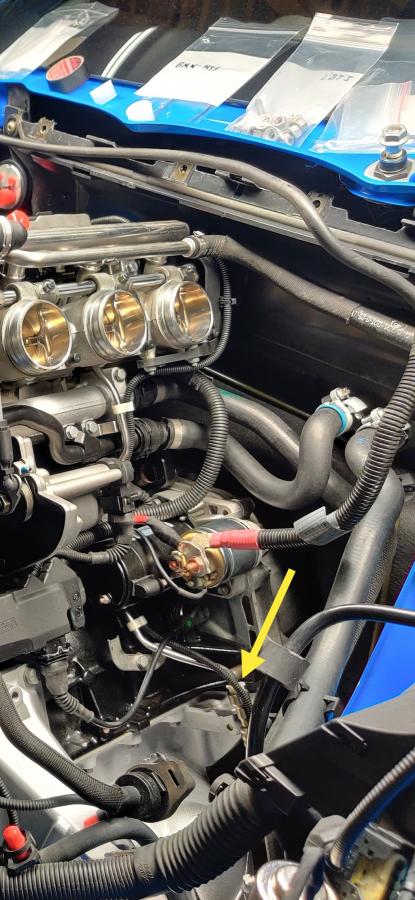

Where the front fuel feed line connects to the fuel feed line?
    Picture below, with circled location.
    Is the circled location is where the front fuel feed line connects to?
    Anyone happen to have picture(s) showing where this location is?
    Thanks.
    You can see the line here, right in between starter and throttle actuator
      Here's a better picture, of the connection as well (near bottom, right under the "i" in "pelican"):
        You can access it from under the car if you reach up on the driver frame rail in front of the fuel filter.
          Okay, so this is probably better place to disconnect the stock front fuel feed line and replace it, rather than trying to do the same from the engine bay.
          Looking to replace the stock fuel line to put in an inline bluetooth ethanol content analyzer with 6AN fittings.

            Yeah, that Quick Disconnect is just below the crank sensor, and it's easier to work under the car (both feet under the tranny and eyes looking up the blue sky head between brake caliper and fender mud guard.
            This is a dangerous place to route the fuel metal pipe so close to the starter 12v stud: a falling screwdriver can touch both and a new fuel injector is created with plenty of sparks around.

              I think you got the idea, but just connected mine last weekend. Here's another angle.
