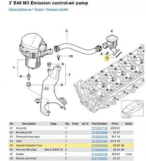

        Just as a heads up, the EGR gasket you have on order is 11727514860, however, RealOEM shows the part number as 11727505259 for the M3 - not sure if there's truly a difference.

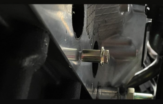

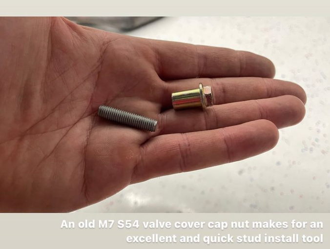

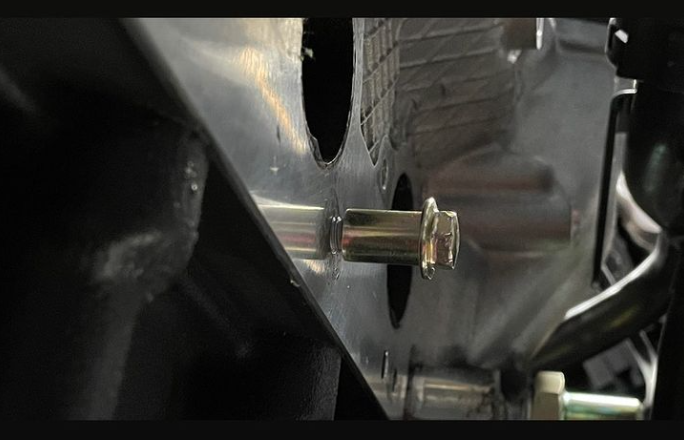

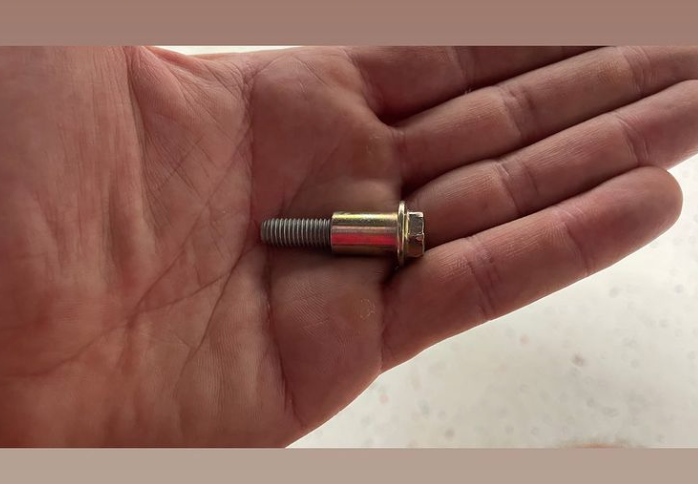

              Just saw this trick for installing the stock exhaust manifold studs using one of the valve cover cap nuts -

                I recently put my SS headers on and it was definitely better having stock studs. I previously had N54 studs and I had to move them around just to get sockets on the nuts. That upper 6th stud wasn't too bad. I use my electric ratchet on all but 5 bottom nuts so it took about 10 minutes versus the hours last time. I've also learned to move the reservoir and unbolt the metal coolant hose. Start to finish from lifting to driving out was about 5 hours. Everyone should invest in an electric ratchet. It's seriously worth it.
