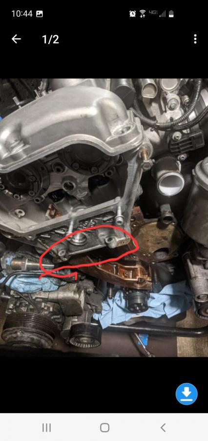

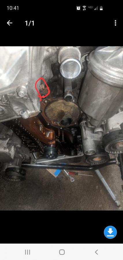

    I am getting a bit of what I believe to be oil building up under the vanos in the highlighted area. I have not found any significant amounts of oil/drops, the highlighted area is simply greasy/dirty.
    I have checked the following items and do NOT believe the cause to be:
    - Vanos gasket/o-ring plate
    - Vanos line
    - Timing chain tensioner
    - VCG
    When driving the vehicle with the windows down I have been smelling burning oil that I believe to be seeping from this area, the harder I drive the worse the smell when comming to a stop.
    Could a timing cover leak cause oil to form on top of the HG like I am seeing? I will have to pull the front clip/radiator and clean this area up and see where the oil forms.

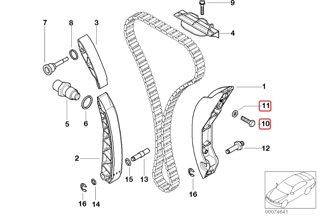

    Have you checked the upper right chain guide mounting bolt and its crushed washer? also, the vanos metal gasket still a prime suspect to me. If the timing cover is leaky then I would expect to see more oil at its bottom than at the top.

      When under the vehicle I can see and feel oil under the head/HG that I believe to be running down the engine from the front.
      Never drops of oil, just a thin film.

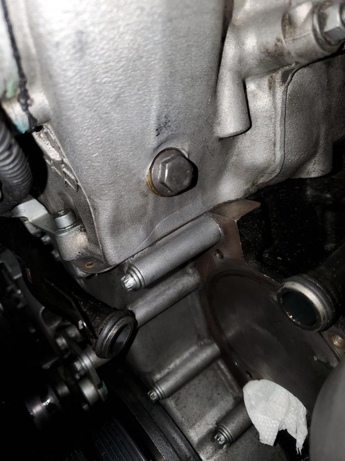

            Edit: Is this the bolt in question?

              Yeah that's it. No need to take anything apart to check if it's leaking. Just shine a bright light between the head and thermostat housing and check for oil/grime beneath the bolt.
              If you see some, try cleaning up the area as best as possible. It's hard, but can be done by spraying brake cleaner and using a rag on a screwdriver. Don't get brake cleaner on your belts. Then drive the car around for a week or so and recheck. This is necessary to rule out the possibility of oil being there from an old valve cover leak or from spills when changing the oil filter.
                Have you checked the upper right chain guide mounting bolt and its crushed washer? .
                These are #7 and 8. Upper right when viewed from driver seat as standard in all books. I didn't mention the #10 and 11 parts because most people had changed the upper right chain guide which worn thin and broke after 70K miles.
                Yes, check #7, 8, and 10, 11.
                  I replaced #8 when I changed out my upper RH chain guide which was indeed broken at 67k miles.

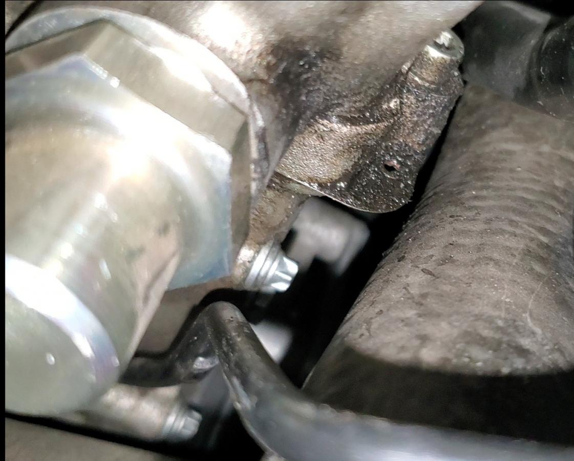

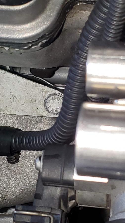

                    No need for a borescope, just shine a light from a bit further up and you should be able to see. Have to play around with angles but it'll work. This is a vid I managed to get of mine when the bolt broke:
                    You'll be able to see all the way down to the block without a screwdriver in the way
                    ​​​​​​Edit: found a couple pics that show the bolt and the angle necessary to look at it with everything still on:
