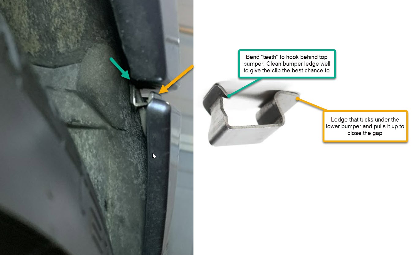

    For anyone that can benefit from a visual representation of how clip 51124015053 works, here is my understanding based on the pictures @Avusbluem3 posted of his clip install (thank you!)

      FWIW, I didn't orientate mine like that ^
      I don't know which way is better, I never tried it like that. I did it in a way such that the clip was orientated in a vertical position opposed to the horizontal position depicted above.
          Verticals makes sense, too. That’s how the clamp on the stock intake cover snaps shut. Ordered my clips yesterday. I’ll try it both ways and circle back with pictures if I can get any decent shots.
