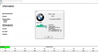

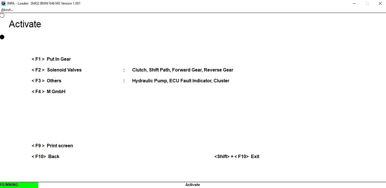

    What version(s) of INPA would have the SMG adaptation? I've got V5.0.6 and the only feature it has is "Activate". I went through those options and it didn't have any for adaptation.

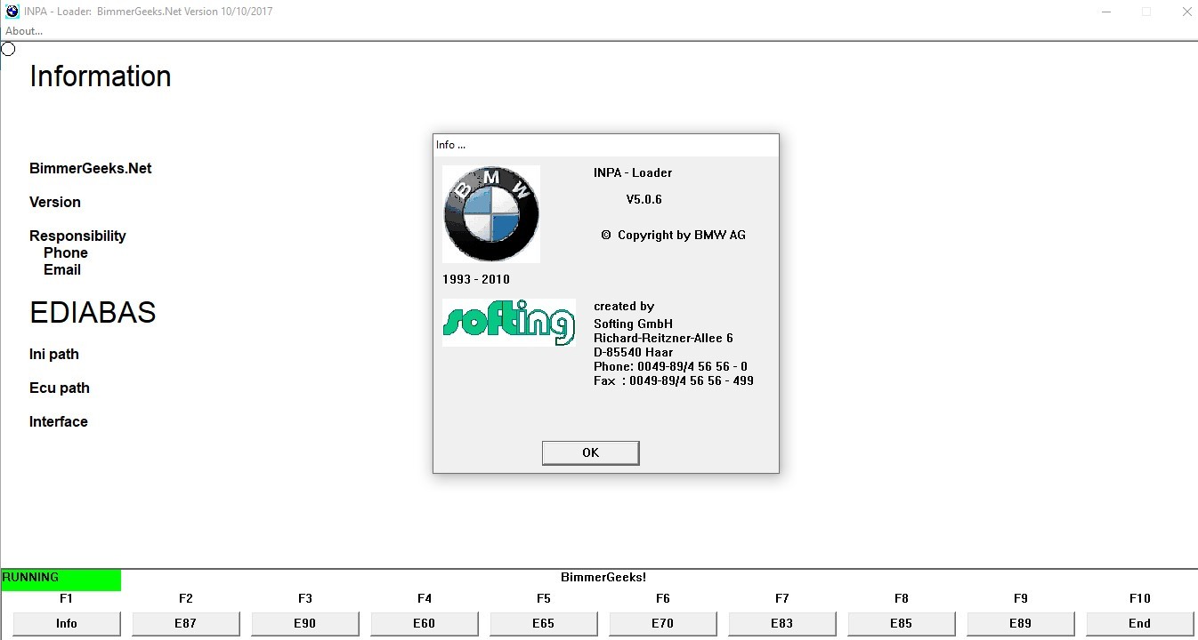

    The version number 5.0.6 is merely for the GUI, it doesn't say anything about the underlying files.

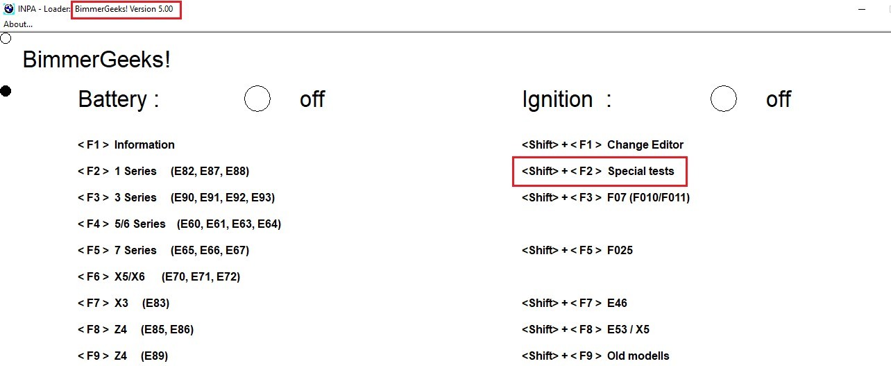

    But regardless, if my memory serves me right, instead of clicking into E46, it is under "Special Tests" if you have that on the home screen.
    F9 or SHIFT+F9 depending on who modified the home layout for your install..
      Correct. Hold down shift and you should see a special or “sonter” menu show up.

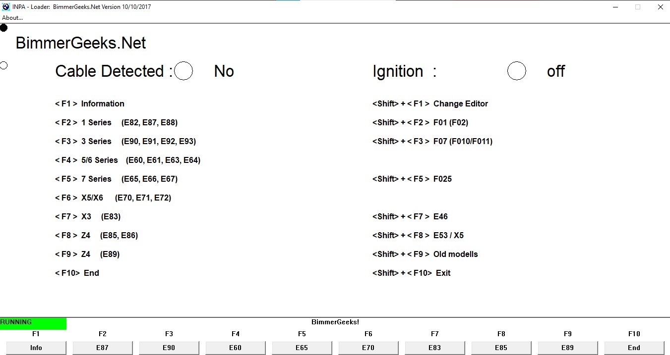

        Unfortunately, I don't have that option on my Home screen, as shown below. I installed my INPA following this: https://www.e90post.com/forums/showthread.php?t=1204192, Would you be able to direct me to where I can add the needed files? TIA!

          Yeah, no problem. I just hate these modified installs when the original files are totally fine.
          Regardless, if you go to "C:\EC-APPS\INPA\CFGDAT" and check for the file named "SONDER.ENG", I think 99% chance that you will already have it.
          If you do, great.
          Open your INPA.INI file (same directory in some text editor like notepad).
          In this example, I'll replace your F01 entry here, since I assume you do not use that one.
          You will see some code like:
          Code:
          F12 = F01
          F12_Text = F01 (F02)
          F12_ARCHIV = SGBD_F01
          Try to replace it with
          Code:
          F12 = Sonder
          F12_KNOPF = Special
          F12_TEXT = Special tests
          Then it should work, let me know if it did :P

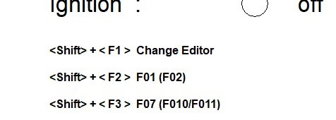

              Unfortunately, it didn't work. The main menu still shows options for the F01, even after editing with the 3 lines you recommended and I also rebooted for s_and_giggles. There must be another .cfg or .ini file.
