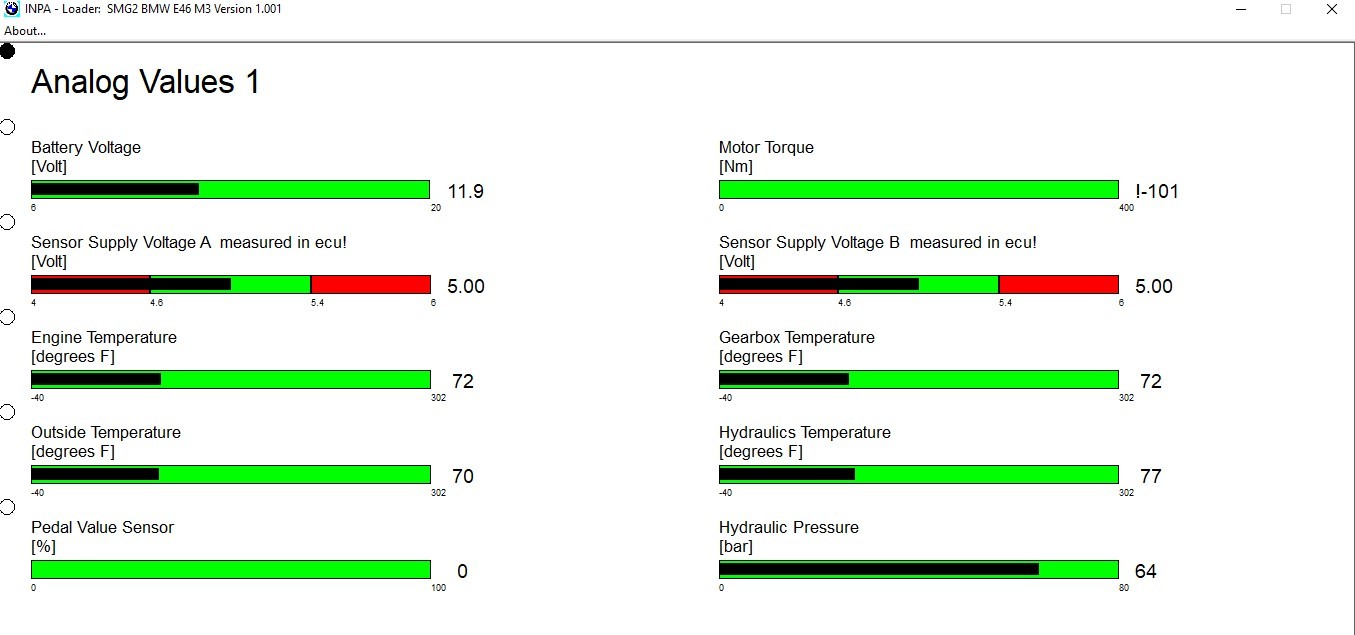

    Is 64 good? Do I need to leave INPA monitoring for about 5 - 10 mins to see if there is a leak?
      64 is okay for a steady state value. However, when priming the pump should reach 80 bar before turning off. So wait until the pressure drops to 45 and you should hear the pump prime again and see it go all the way up to 80 again.
        Also just noticed that your batt voltage seems low. During SMG adaptation you should try and keep the batt voltage between 12.5 and 13.5
          Thx! I just noticed that. Weird, I've always had my Deltran hooked-up during the tests. This go-around it was at 12.1. As for the pump, I waited 3 times - it would drop to 48 and only go up to 66 bar. Would a hydraulic pressure leak in the pump or in the seals have visual signs outside? I didn't see any leaks outside the reservoir or pump.
