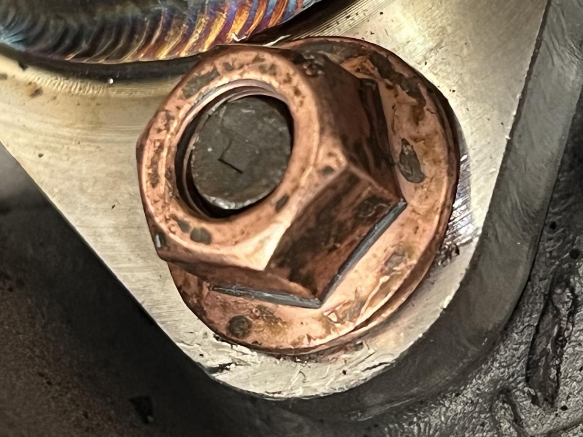

    I'm ready to install my SS V1 stepped headers from the recent GB and thankfully I have a friend who has a spare head with gaskets and standard S54 studs with which I was able to test fit the headers. A couple of questions:
    1. I was able to get 5 full rotations of the thread with the nuts on standard s54 studs with gaskets - is this sufficient? (see pic below of test fitment). I also acknowledge I will not have the same leverage to tighten all 18 in the car the same as I do with a motor outside of the car.
    2. If 5 full rotations on the nuts is not sufficient, which manifold studs are recommended? Really hoping this isn't necessary but also want to make sure the headers are secured with no leaks.

        I used N54 studs but that was mainly because the last time I did studs was 10 years ago lol.
        As long as you don't have any leaks (looks like you won't) you're good.

                Thanks all - seems the stock studs should be fine.
                  I would strongly recommend going back over and retorquing the nuts after a couple of heat cycles...a couple of them always seem to loosen up.

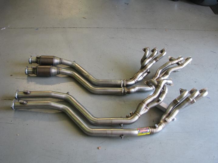

                    One more question - the SS headers didn't come with flanges on them so I assume the stock OEM flanges (headers to section 1) fit to the catted SS section 1 but hoping somebody can confirm.
                      No, the SS 2.5” section 1 slips over the SSV1 headers.

                        No, the SSV1 headers slip over the SS 2.5” section 1.
                        Got it - thank you!
