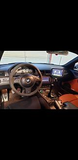

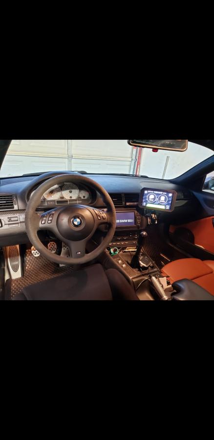

                What is he going to display the temp on? Very few people have a hard mount for their phone.
                Ah I guess you're right. You would have to buy a hard mount to use your cell phone as temp display. Might take some creativity. Here's my mount that I can switch between my cell phone and garmin for track days.
                Click image for larger version  Name:	Screenshot_20220615-095156_Gallery.jpg Views:	0 Size:	31.3 KB ID:	172253
