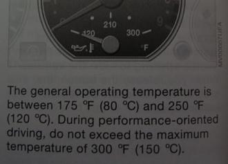

Name:	E46 Oil Temp.jpg

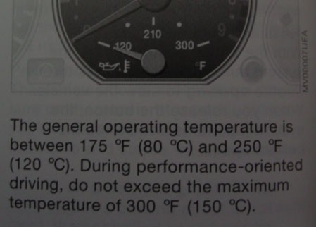

    This is what the owner's manual says about it. :P

              3/4 dot (255ish) isn't crazy hot for oil on track. Those dots on the gauges are supposed to represent the operating temp under normal circumstances, so 3/4 on the gauge is still fine for the street according to BMW, let alone the track. Like the manual says in that pic above, TWS is supposed to be good up to 300 F.
