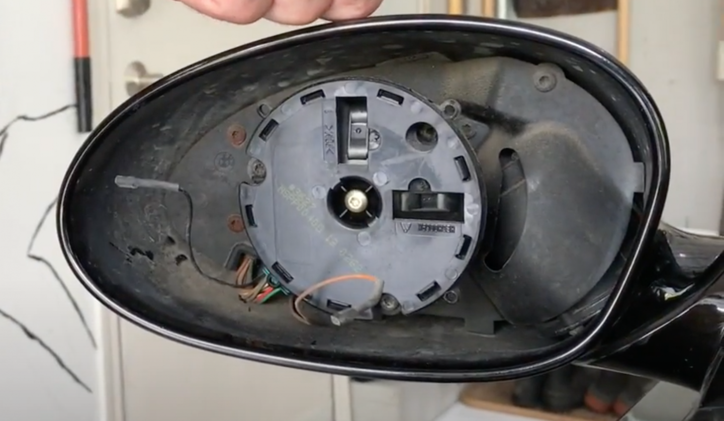

    2. You should now see something like this (not my pic):
Name:	Screen Shot 2022-06-20 at 6.56.33 PM.png
    Note that the heater wires (brown and black with female spade connectors) are coming out the bottom left. Since this is the driver's side, we want them to be coming out the top right so that they play nicely with the new glass.

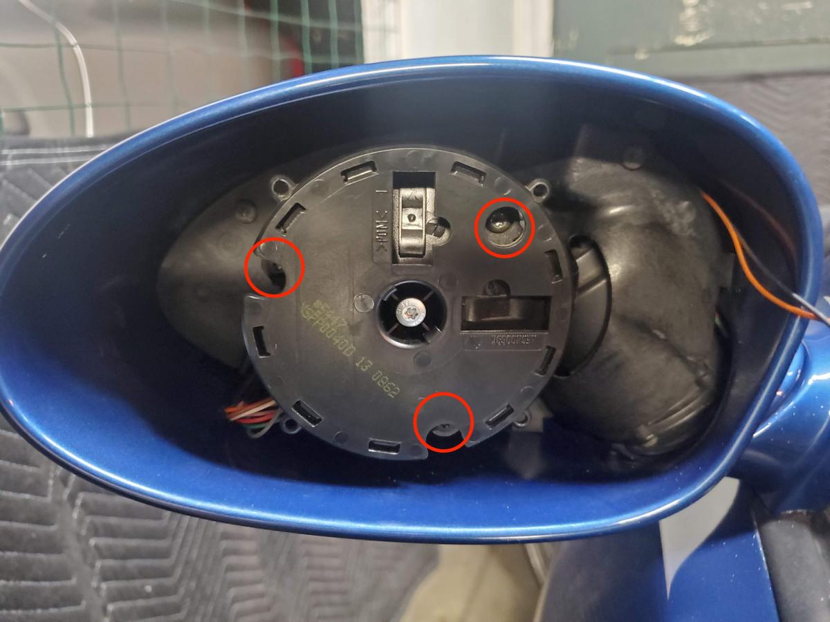

    3. Remove the adjustment mechanism by undoing the three T15 screws (circled in red) holding it in:

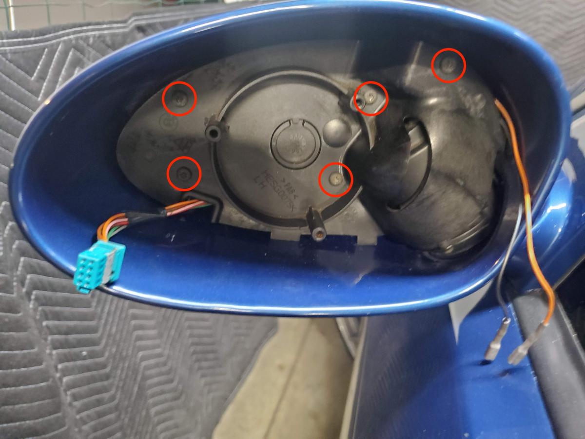

    5. Remove the black plastic plate behind the adjustment mechanism by undoing the five T15 screws (circled in red) holding it in:

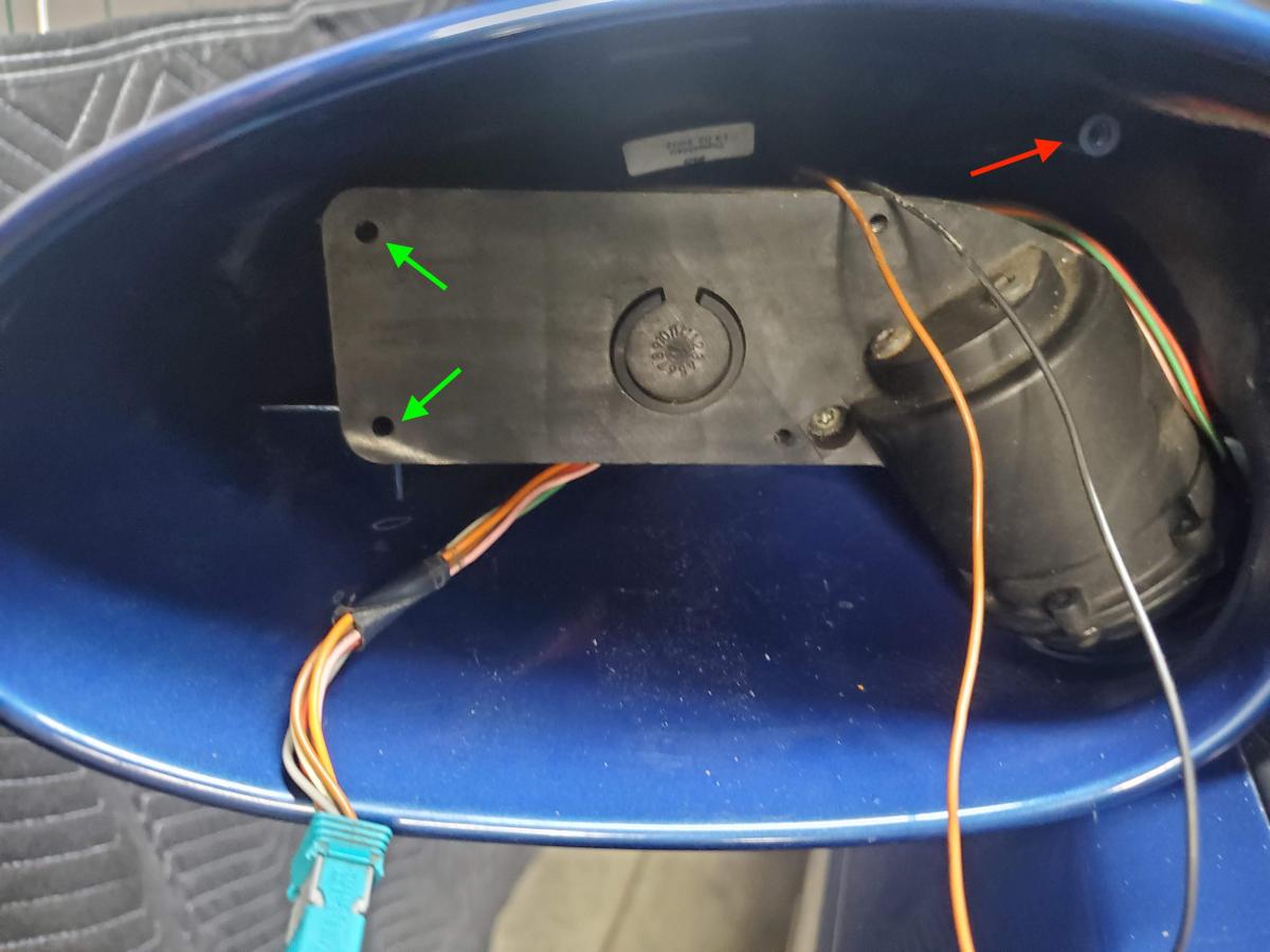

    6. The painted shell of the mirror will now be free (but will not fall off). Remove any tape holding the heater wires to the rest of the harness and move them over to the side closest to the passenger compartment (i.e. right on the driver's side and left on the passenger's side).
    To move the wires over, I first moved them past the two outermost screw posts (green arrows) and then made sure they went under the topmost screw post (red arrow):
