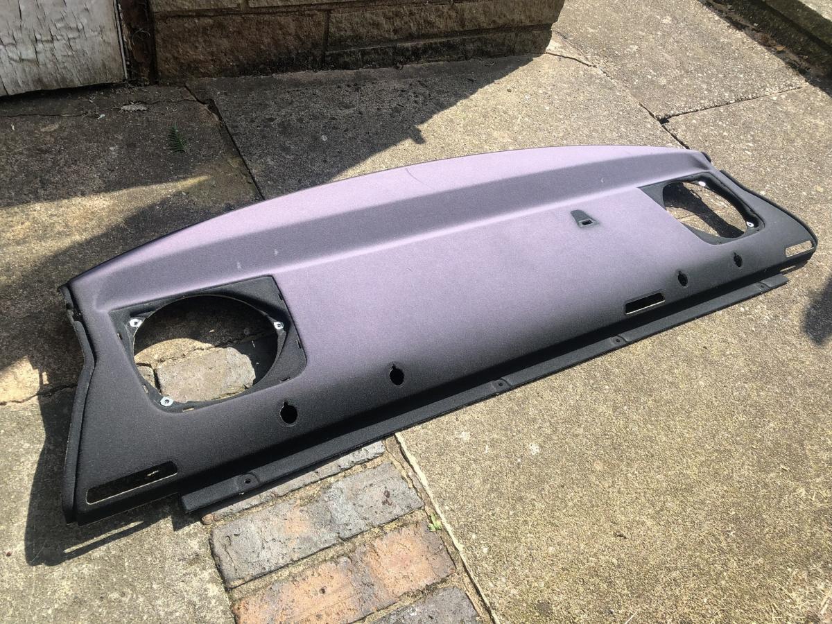

    Hey folks,
    Just touching base on a common problem that our cars suffer from - which is the parcel rear shelf fading to a bluish purple over time.
    The solution is to either redye / paint the shelf back to anthracite or to replace with a new shelf (depending on how far you want to go).
    Both have been covered in more depth on various forums throughout the net.
    However, my reading indicates that there is not much emphasis on prevention. And so I’d be keen to establish what products people are using to stop this from occurring once the shelf has been rectified or replaced?
    I’m aware that some claim that window tint is a successful prevention method, however I am not keen on this. There was also a thread on the ole M3Forum.net which was useful but I can’t remember the details.
    If you have restored or replaced your parcel shelf, I would be grateful if you could share your methods of protection, ie ceramic, fabric guard etc.

    I redyed mine 5yrs ago and holding up strong. Not garaged kept and still looks the same. I do have Air80 window tint, which are barely noticeable but helps protect my interior
      I have a new one as well, since 2 years or so. Not leaving the car in the direct sun outside seems to be the prevention method.
        To get the black finish and make it look even better, I would opt to re-upholster it in UV-resistant alcantara.

                  I sprayed mine with fabric color over a decade ago. My rear glass was ceramic tinted around the same time. It’s not faded since but it’s presumed because of the window tint and not the fabric spray being some ultra fade resistant formula. Good luck.

                        Just throwing it out there - I am dying my rear shelf because it's completely purple like the photo above as well.

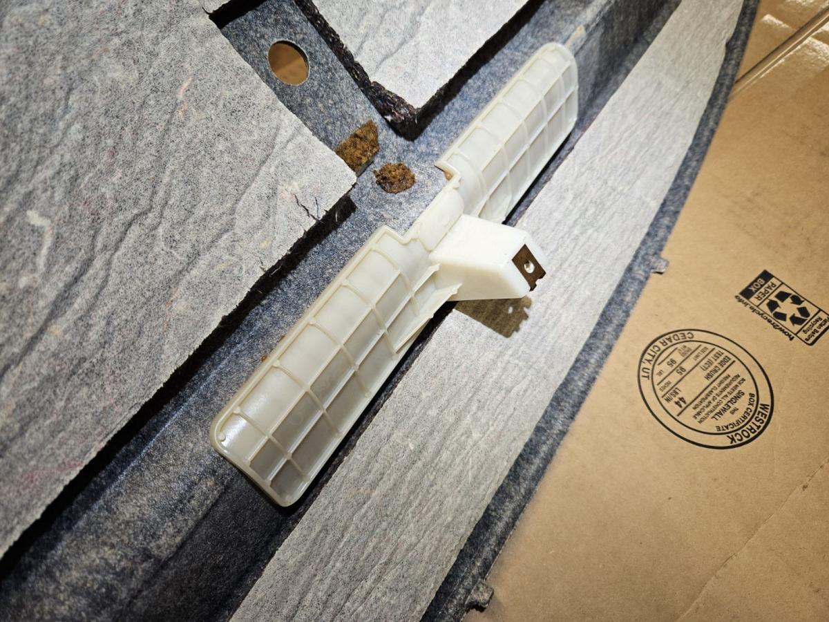

                        On my 05, there was another center screw holding the shelf down that is not mentioned in ANY diy or video out there. In order to access it you must remove the speakers from the trunk and it's an 8mm screw from the bottom.

                          Thanks for the info. This is another item on my list of to dos on my '05.
                            Yeah it's not very hard but it is extremely time consuming just to get the shelf out. I had to take mine out to remove the rear tint, I thought it would take 10 min, it did not.
