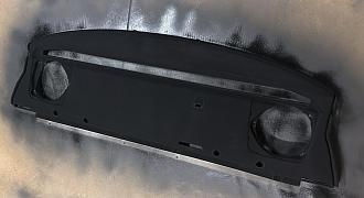

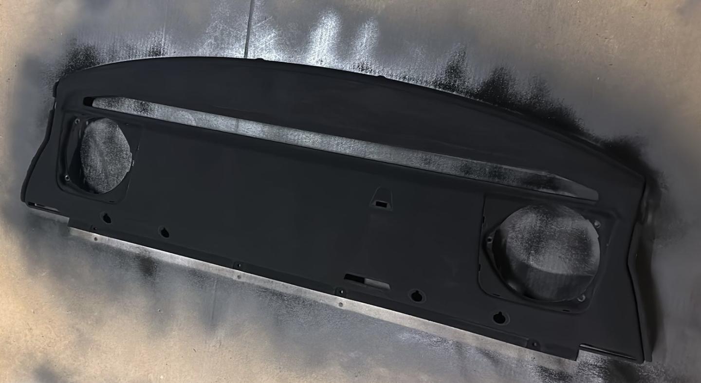

              I have painted a few now, some things that I have learned are:
              Do not bother trying to source paint meant for fabric, the ones that I used this on actually turned out worse, for best results, use simple cheap matte black spray paint.
              When painting with the black paint, the initial coverage may seem poor, at which point one might be inclined to add a lot more paint by applying several wet coats in rapid succession.
              However, I have found this causes the paint to bead together in certain locations, which leaves a really rough and poor finish, and it still requires a lot of paint to get somewhat decent coverage.
              The thing I found that works best is running a light coat not too close to the shelf, and then letting it dry completely, not just flash off for 5 minutes, but for example wait an entire hour, afterwards apply another light coat, and repeat until done.
              Doing it this way you need far less paint and see the coverage increase quickly (vs. barely at all when doing wet coat after wet coat) and less paint means a better and less rough finish.
                Click image for larger version Name:	ab037113-abac-4439-8acf-855dc1e0efff.jpg Views:	1 Size:	94.4 KB ID:	262060
                Definitely agree with your technique if going the painting route. Too much paint will glob up then you're screwed.
                The fabric paints they sell are rubbery and flexible compared with a regular paint that might be brittle. But if it works it works!
