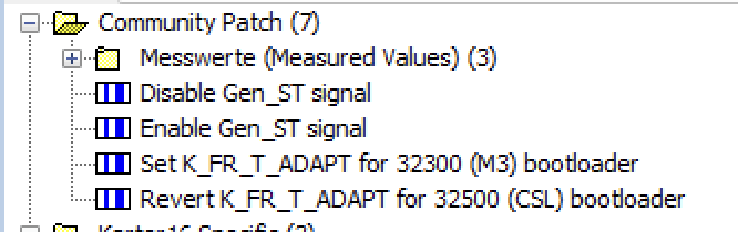

    3: Take the Tune (partial) binary and make any changes that you need to to it (common changes are things like VANOS offsets, disabling certain DTCs, etc.).
    3a If you currently run a CSL program and tune and are converting to Community Patch you can use your existing tune, with the following caveats: (1: if using the M3 boot loader you need to set K_FR_T_ADAPT to 0x100. 2: If you are currently sending the Alternator (GEN_ST) signal over CAN you need to set K_GEN_CFG, K_GEN_TP and K_GEN_HYS accordingly. The easiest way to do this is to use the XDF reference below and apply the appropriate patches)
