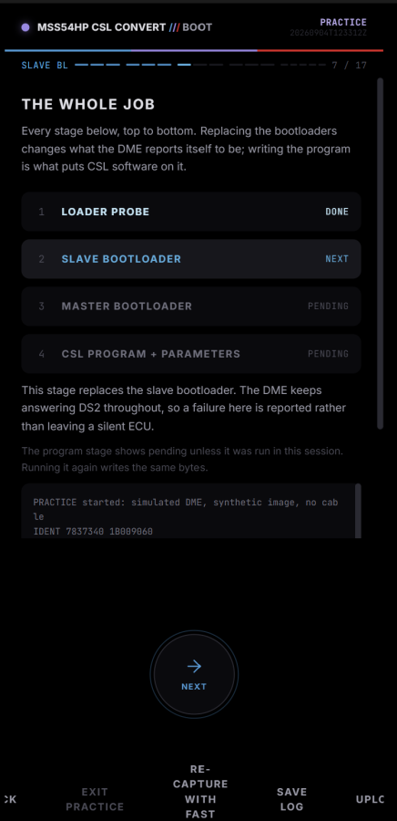

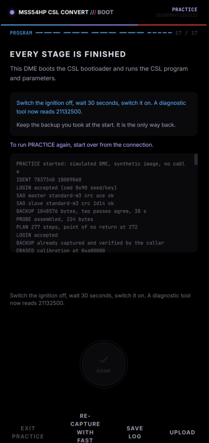

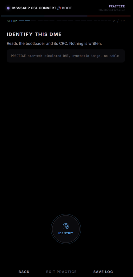

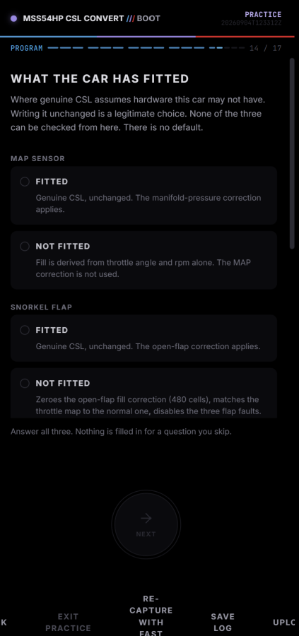

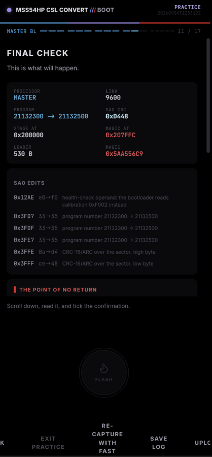

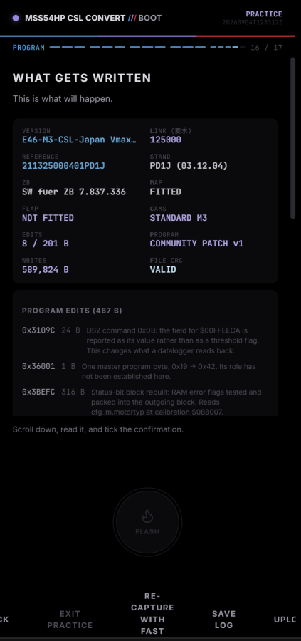

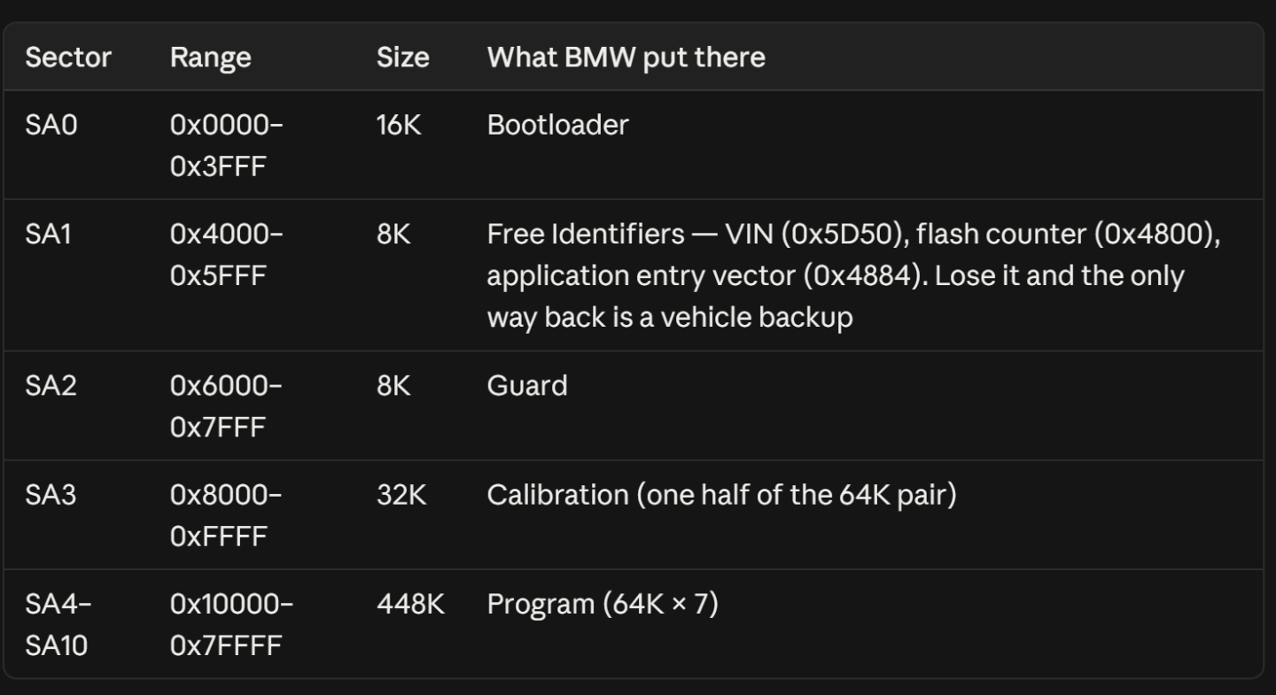

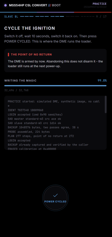

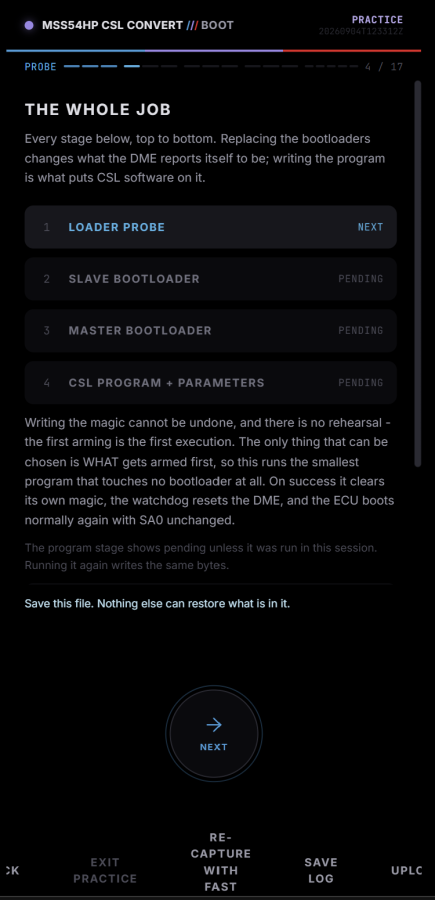

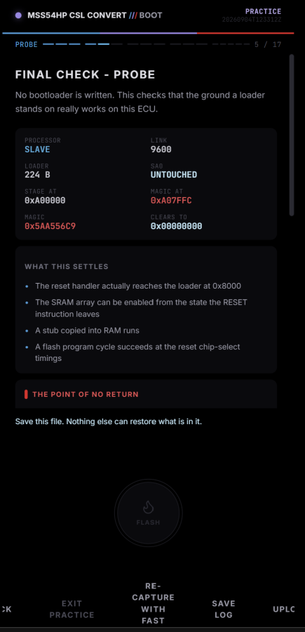

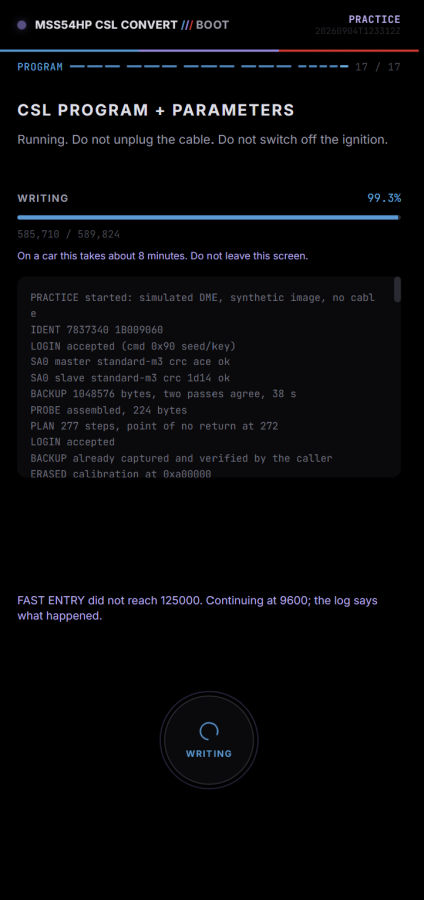

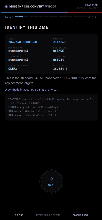

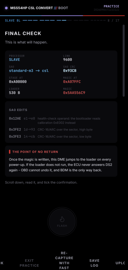

                      On a bit of a whim, I built a prototype tool that rewrites the bootloader (BL) over OBD.
                      Everything except the BL part has been tested — the BL itself is the one thing I'm still too scared to try.
                      Here's the outline of how it works.
                      As a starting point, my understanding is that the Am29F400BB is organised into sectors SA0–SA10 (SA = Sector Address).
Name:	スクリーンショット 2026-09-04 213944.png
                      The flashing we normally do over OBD goes through the BL in SA0, using the DS2 protocol. Which means rewriting the BL by the usual method was impossible over OBD — the BL can't erase itself.
                      So the tool takes this approach:
                      1. Place a loader in SA3, which DS2 can write freely.
                      2. Write the magic value 5A A5 56 C9 to 0xFFFC at the end of SA3, then power cycle. On reset the BL sees it, jumps to the loader in SA3, and the loader rewrites SA0.
                      3. Power cycle again — the new CSL BL comes up.
                      4. Write SA4–SA10 and SA3 to that CSL BL over DS2. ← same mechanism as the existing tools.
                      5. Once each for master and slave.
                      SA1 is kept as it is on the car, so you end up fully converted to CSL while retaining your own VIN and AIF.
                        I use my M3 as my daily driver for pretty much everything, and this weekend I'm taking the family on a longer trip. I plan to test after that gets out of the way — though I haven't given a single thought to what I'll do if it fails. I don't have a spare DME either.​
