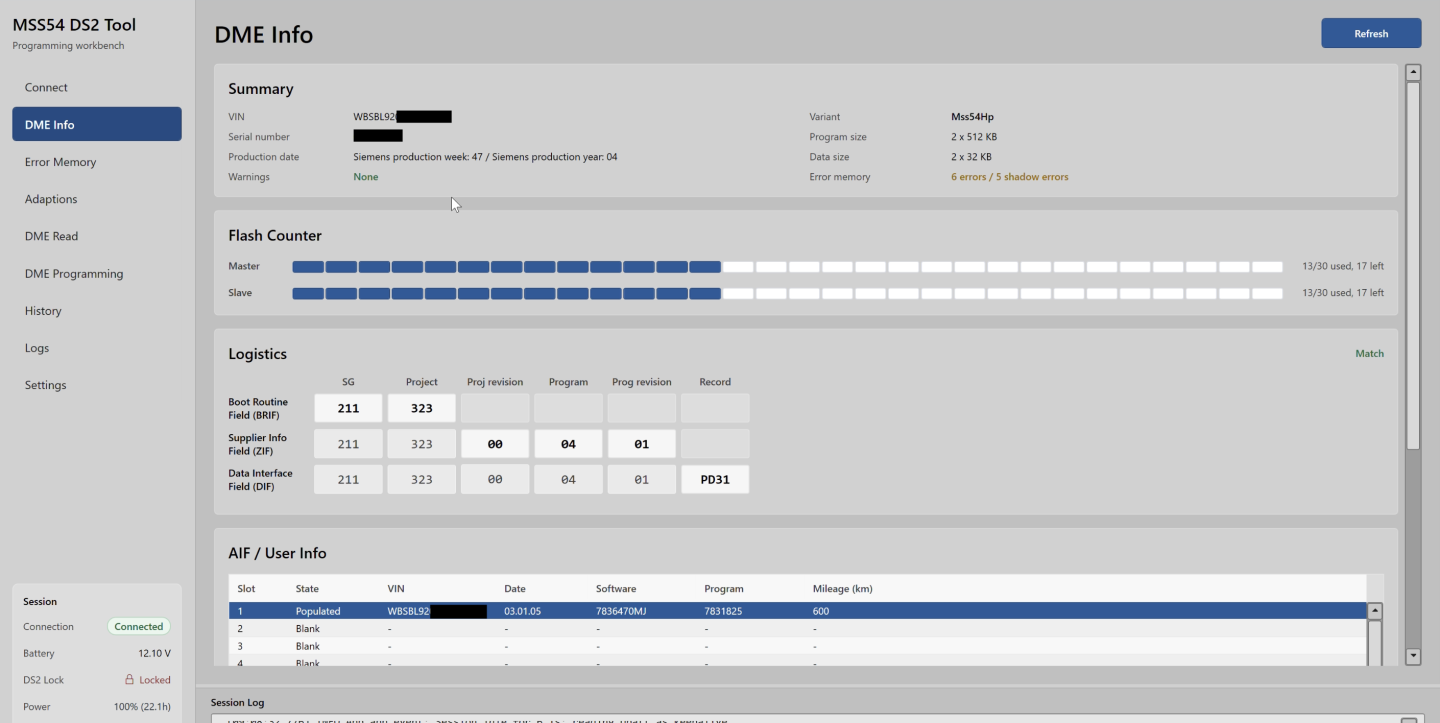

    DME Info Screen
    - Key DME info (VIN, Serial, Production Data, Variant, etc. Summary of any data integrity, errors, etc.
    - Flash Counter
    - Logistics info (these are the bootloader / program / data numbers that are frequently referred to)
    - AIF records

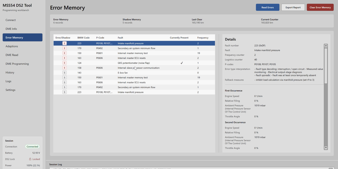

    Error Memory
    - Read Error Memory
    - Read Shadow Error Memory
    - View detailed info about errors as well as interpretations of the exact error types for that error.
    - Export report of errors for sharing
    - Clear Error Memory

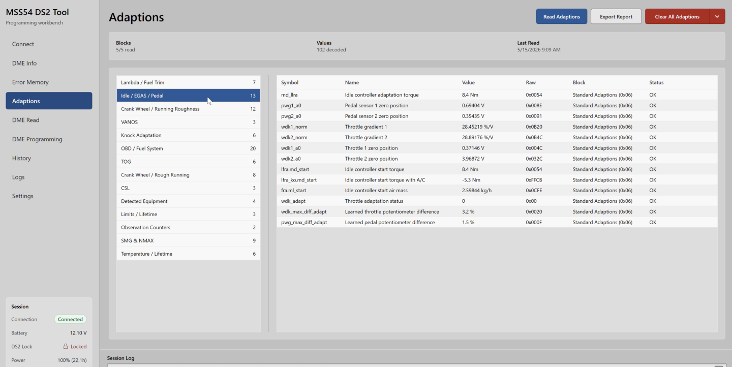

    Adaptions
    - Read Adaptions and view interpreted data
    - Export Adaptions for sharing
    - Clear Adaptions (either all at once or specific categories only)
    Click image for larger version  Name:	4-Adaptions Screen.png Views:	0 Size:	236.4 KB ID:	355308

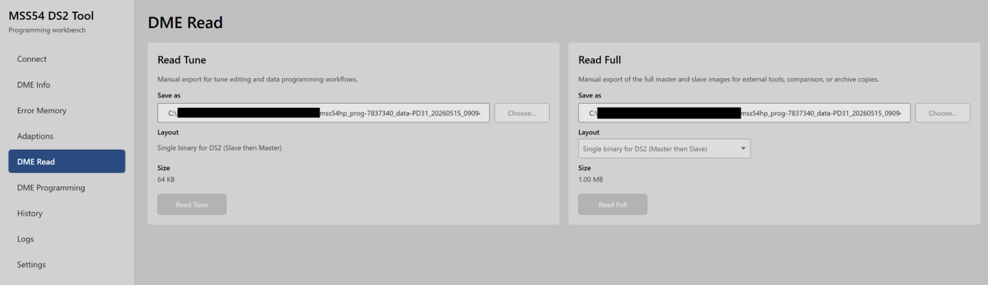

    DME Read
    - Read out current Tune off your DME
    - Read out current Full binary off your DME
    Click image for larger version  Name:	5-DME Read Screen.png Views:	0 Size:	86.5 KB ID:	355303

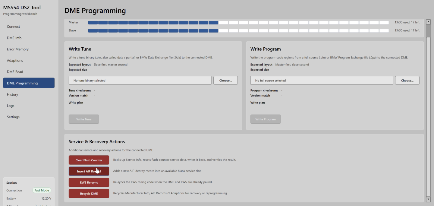

    DME Programming
    - Write Tune (.bin or .0da)
    - Write Program (.bin or .0pa)
    - Clear Flash Counter
    - Insert AIF Record (free type, copy existing, insert from another binary file)
    - EWS Re-sync (for when a paired DME and EWS3 module have got their rolling codes out of sync).
    - Recycle DME (aka virginization. This entirely wipes the Service Info and Adaptions blocks. If you don't already understand what this is and why you might want it then don't go near this, if you try to you're going to have a lot of pop-up confirmations to deal with)
    Click image for larger version  Name:	6-DME Programming Screen.png Views:	0 Size:	176.0 KB ID:	355307

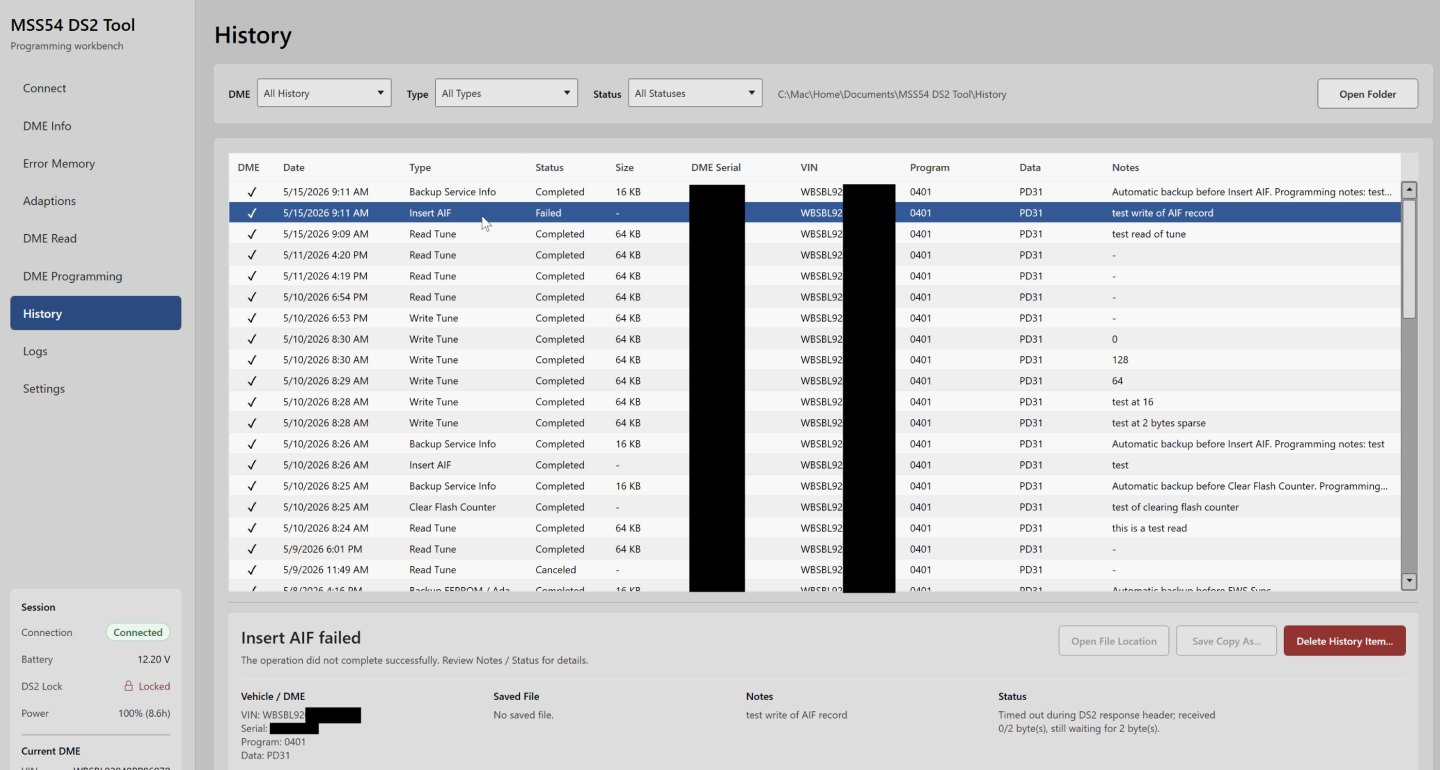

    History
    - The app captures everything you do as an item in the history, indexed to the DME serial number. This means you have full history of what you've done, and means you can restore to any point in that history.
    Click image for larger version  Name:	8-History Screen.png Views:	0 Size:	315.8 KB ID:	355309

                    That Adaptation piece is awesome! Amazing tool!
