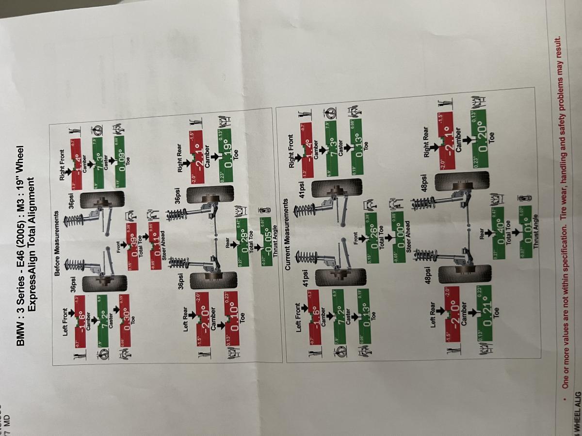

        - Will post the alignment spec sheet below

        EDIT: After reading my alignment sheet it says 41 psi in the front and 48psi in the rear after the alignment. That is way too high, isn't it?
            I keep my tires at 41 and 48 so no. If you do 100mph, there's a warning on the door that says put it at that. I have tracked my tire wear and it has been very even. If you don't do 100+, stick to lower pressures. It's not pressures for the track, but the street.
            Bushings need to be preloaded before torquing them. They need to be in the position they will normally be at when the car is sitting in your garage everyday. If you torque them in the air, they are not preloaded. When you lower the car, the suspension and the weight of the vehicle twists and loads the bushing creating a constant massive load on the bushing. So now all the rubber bushings are twisted and tweaked when they are only meant to do when there's compression of the suspension.
            Try setting pressure to 33 and 35 like the door says. Your camber is quite high which may not be the cause but is absolutely a contributing factor. Those specs are intended for a car with 150lbs in both front seats, 150lbs in the back seat, a full gas tank, and 40lbs in the trunk.

                That alignment does not look great. Having more camber in the rear than the front may contribute to your problem. That is also too much toe-in on both ends, especially in back. Other than that, it seems like you replaced most things. Maybe engine mounts?
                  That camber in the rear is nothing out of the ordinary for lowered cars.
                  The rest of the alignment spec is ok...when static.
                  If the front control arms have worn balljoints, a good alignment tech would know, but a jobsworth may not.

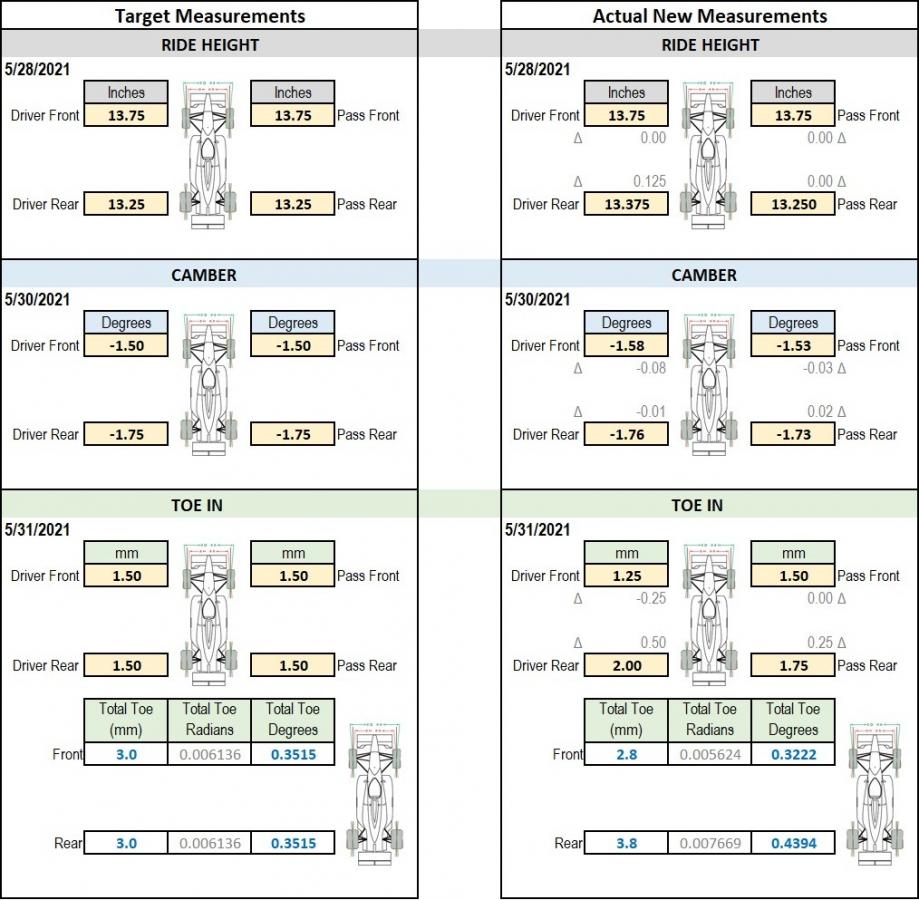

                        Also, the alignment may not be part of the problem, but toe-in is slightly over the already conservative factory spec in front. It is also a full twenty-five percent too much in the back. The general idea with camber is to have more in the front than the rear.
                          That's not a lot of toe.
                          Toe in will make the car more resistant to changing direction. Zero toe or toe out will make the car darty.
                          The dartiness you're experiencing might be due to the toe. Camber isn't excessive so you could just be feeling a twitchy feeling correlated to toe. But it's not that much of a change from your pre-alignment specs so not sure what's up with that.
                          Also, 41 and 48 psi cold could be causing some of what you're feeling. Like others have said, drop the pressures and give it a go.
                          EDIT: I misread your alignment from my phone. You're total toe F/R is 0.26/0.40 (I misread as 0.026 and 0.040 from my phone). I went to find my car's alignment spec (below pic) on my laptop when I noticed my mistake. I'd drop the tire pressures and try that first.
                          Click image for larger version  Name:	Alignment May 2021.jpg Views:	0 Size:	116.2 KB ID:	174625
