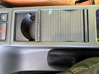

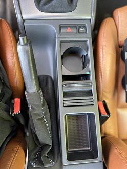

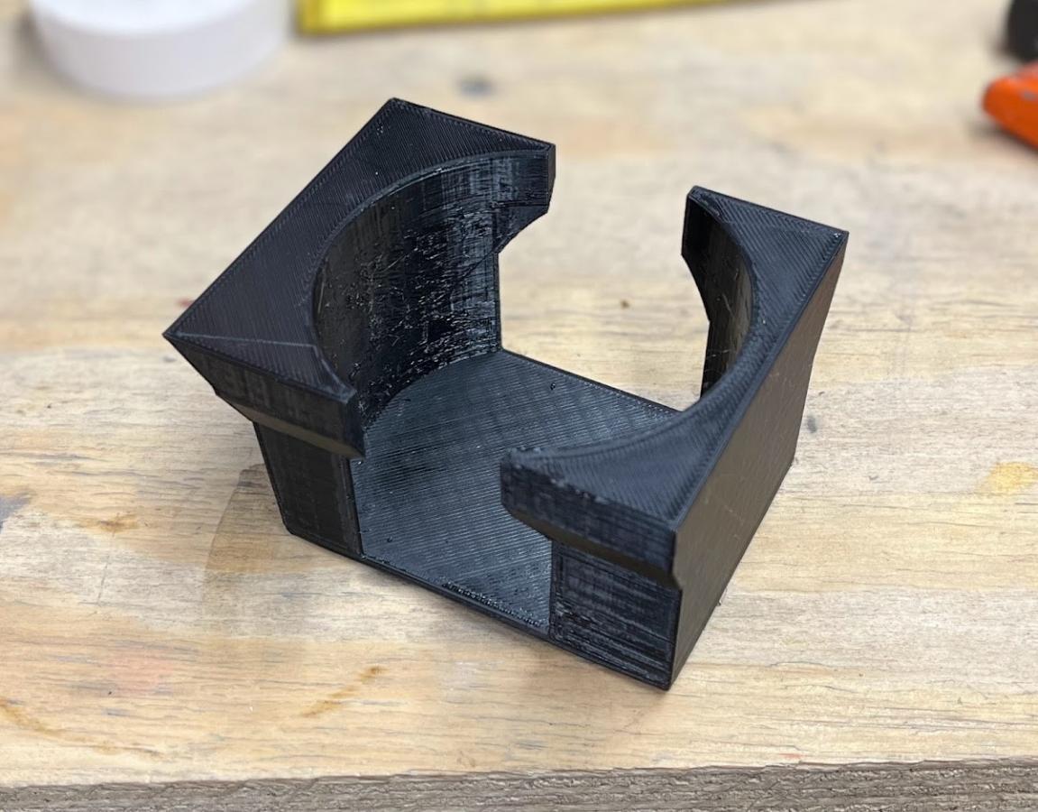

    For those folks with the Euro Center Console Tray but still want a cup holder in your E46, this insert will fit nicely inside and will be hidden with the sliding door closed. Friction fit but you can also use double sided tape for a more secure fit. I'm currently using this in the "small" Euro tray. Print in ABS or PETG for better high temperature tolerance. No supports required.
    Yes, I know. Sort of defeats the purposes of switching to the Euro Tray. I like the clean look of the Euro Tray but like the functionality of the cupholder from time to time. Best of both worlds now. Opening is 68mm, fits a soda can.

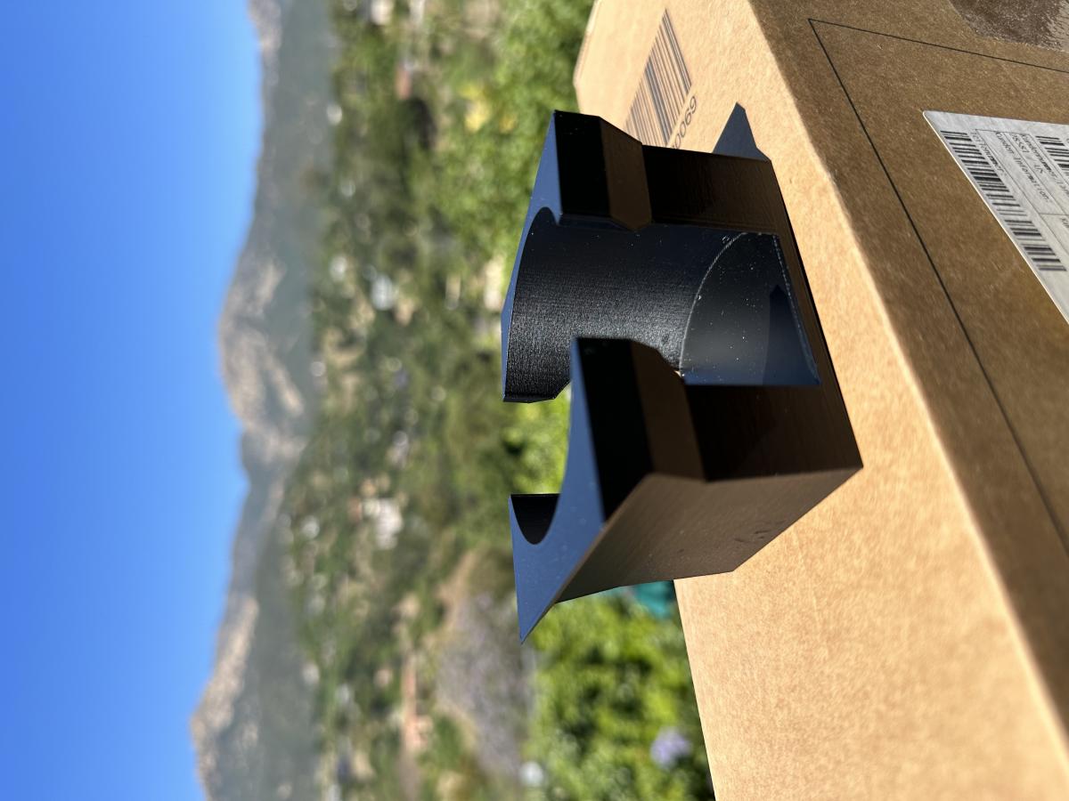

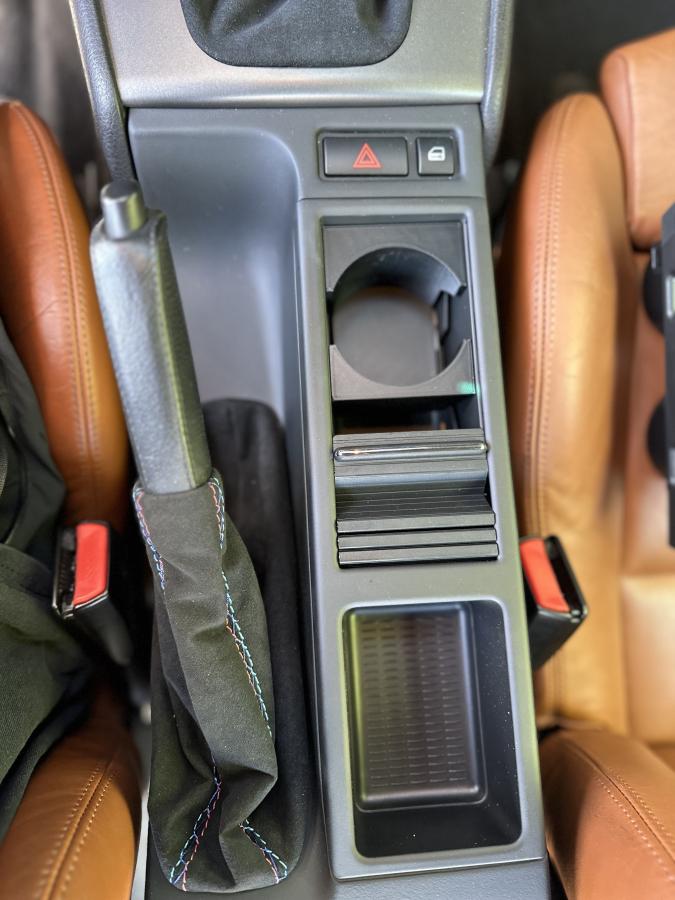

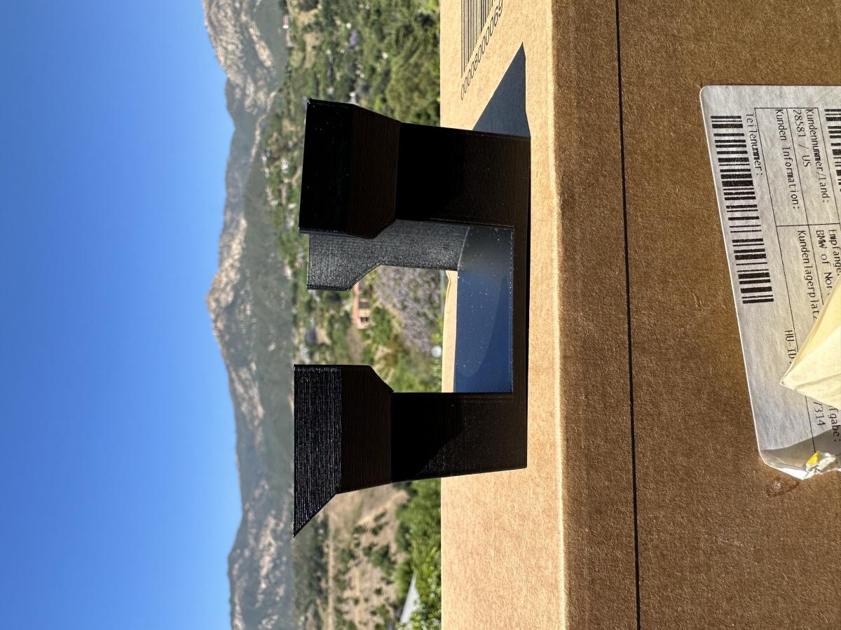

          You’re the man OP. Got this 3D printed and painted matte black to match the center console by TexaZ3
