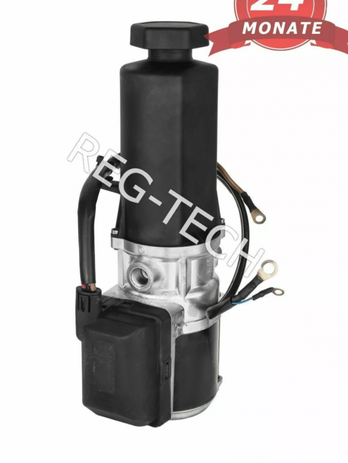

                  I’ve seen two setups - one from Mercedes and the other from the Toyota MR2.
                    I do not know what the MR2 setup is like.
                    I have research intensively on the Mercedes setup.
                    it seems like a very simple system as it's an all in one system that make it very easy to mount and wire.
                    One caveat tho, the Mercedes w168 pumps at 71-75bars whiles the original pump is at 110bar @ idle. people with this setup often say that it's like driving a car with under pullies. The weight/feel is very similar to an E90.
                    ​​​​​Here is what the pump looks like.
                    *edit* i do not know of any thread or videos. It is a very simple system as it need pressure hose and return, relay for power/ground and alternators *on*. Bracket to hold the unit should be very simple as well to.fabricate.
                    You will then remove the hydraulic pump and run a shorter belt.

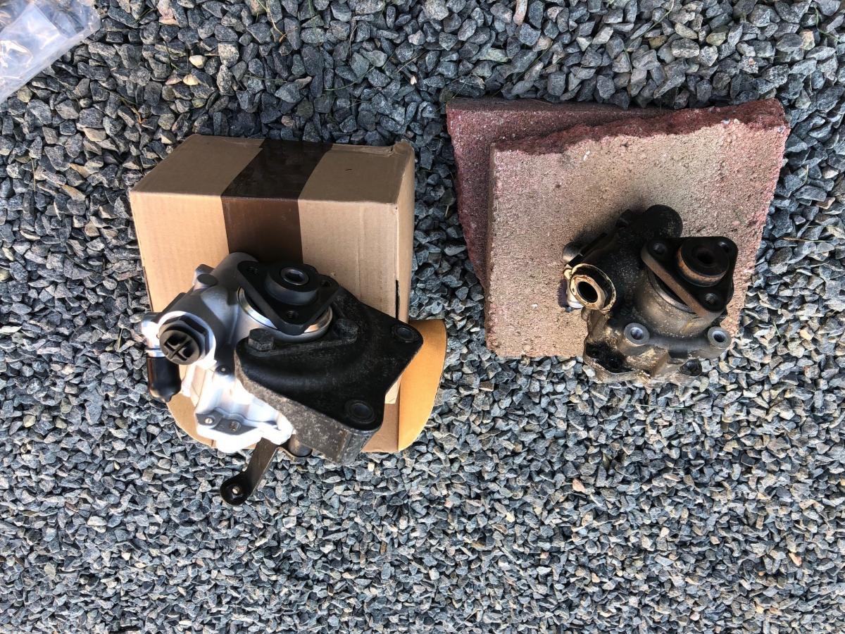

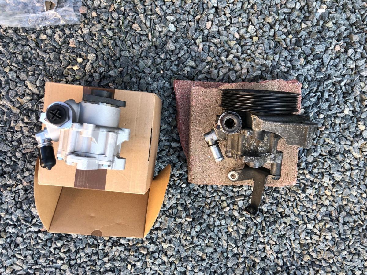

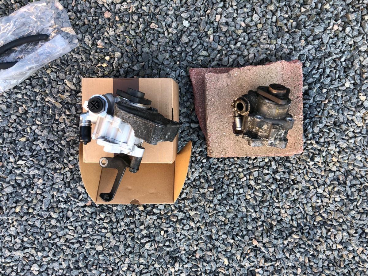

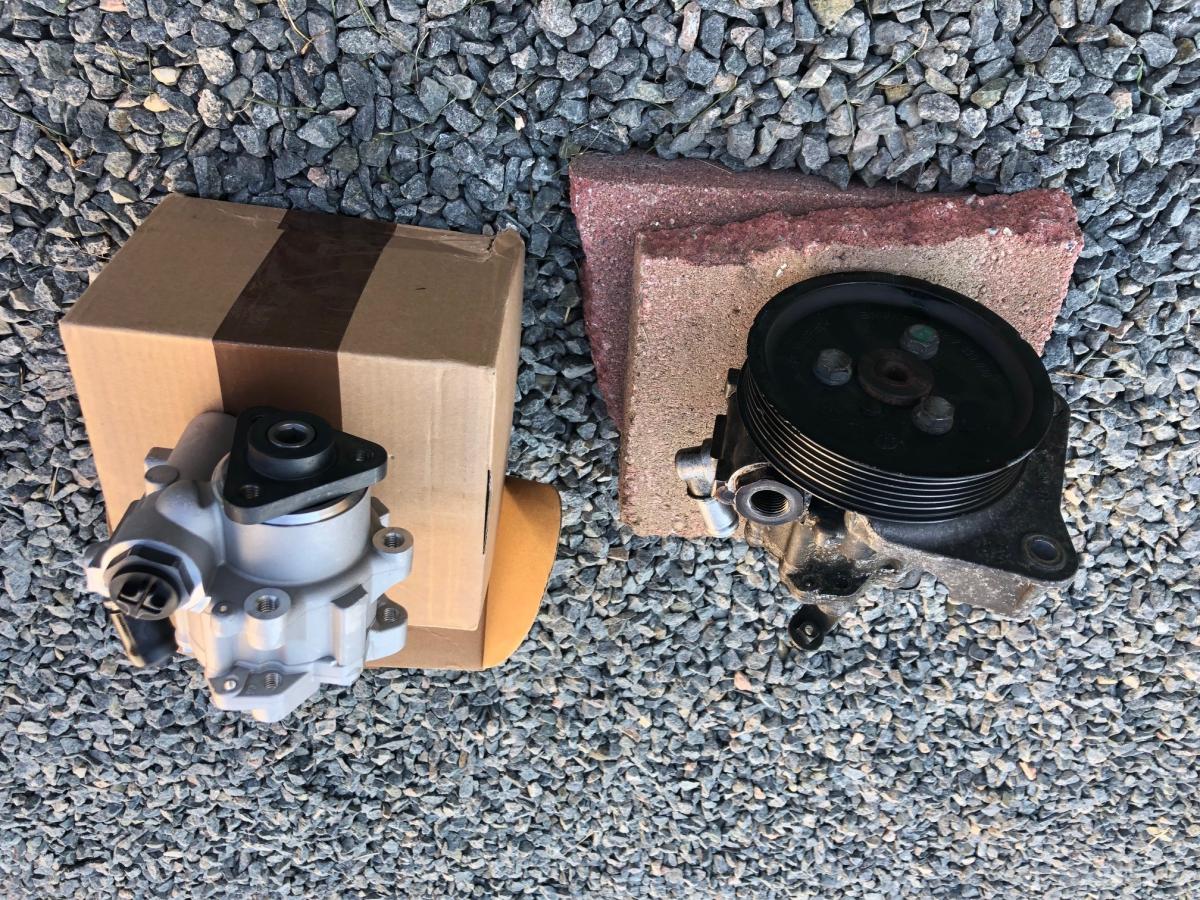

                            M54 pump bolted in fine. no issues.
