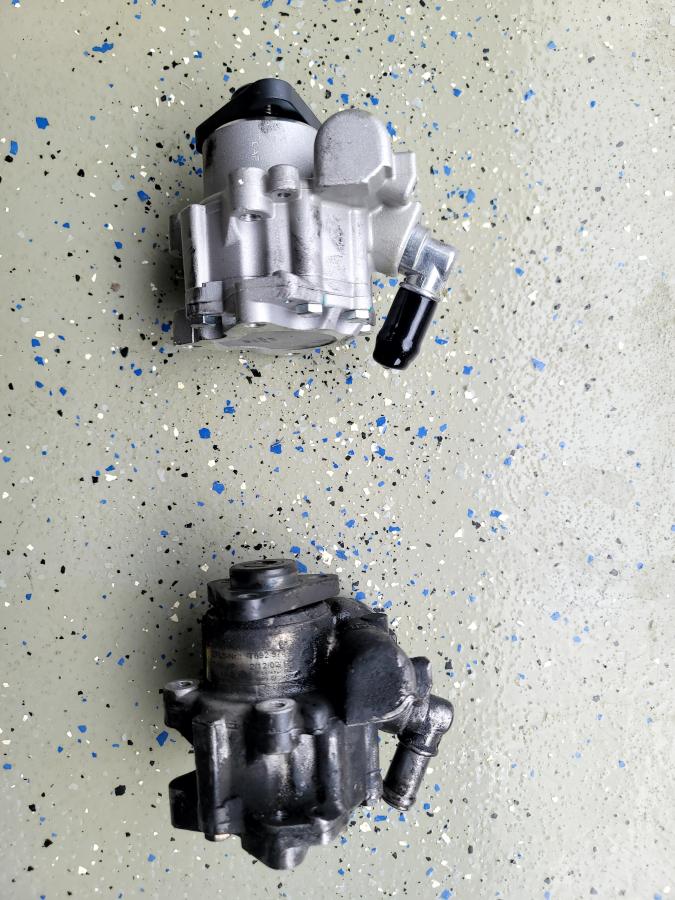

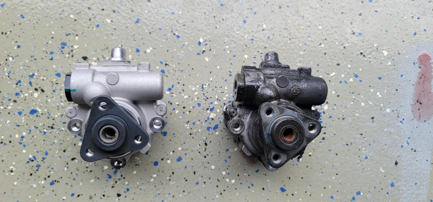

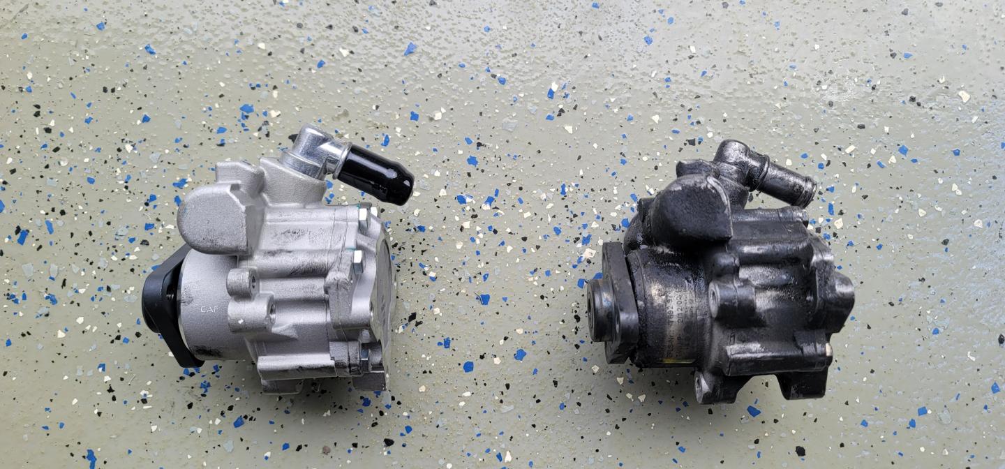

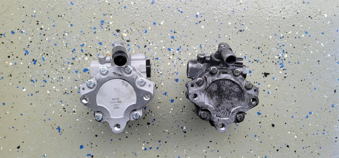

          this interests me. I did not have the time to tear the old pump apart as I was trying to get the car ready for a track weekend. What I can say definitively is that the M54 pump bolted up no problem and the steering feels normal.

            Here is a few pictures of my old pump and the replacement aftermarket pump for the M54.

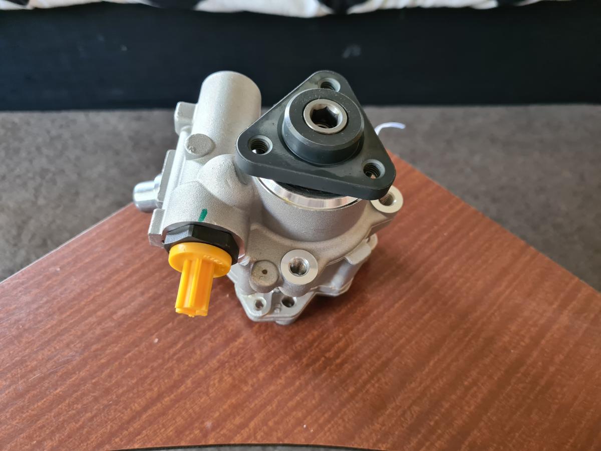

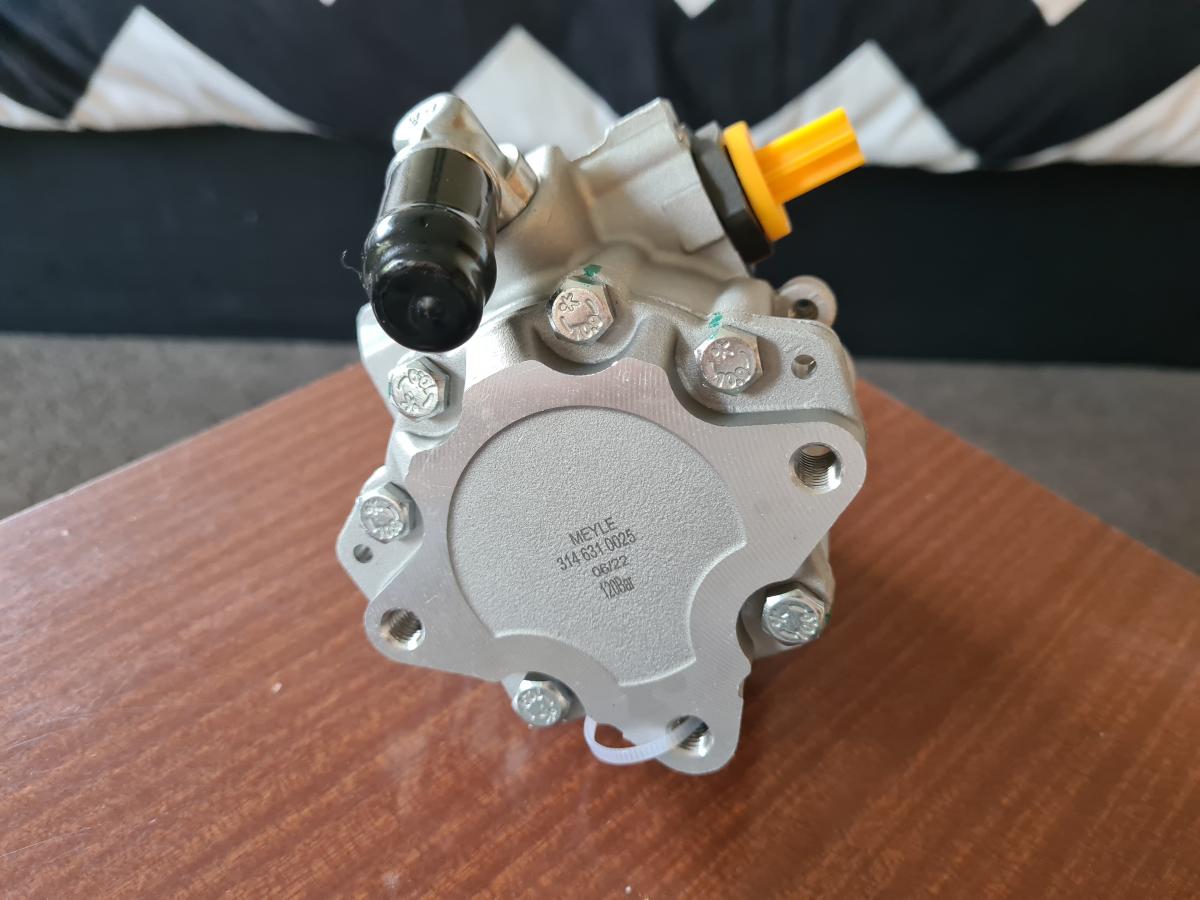

                          Haven't installed yet but I ordered an X5 pump (32416757914) from schmiedmann since my pump was starting to whine when hot. Opted for the Meyle one since it seemed the best cost while still being an OE manufacturer just not for this part. Schmiedmann do have a 'trucktec' brand made pump for $100 but I've never heard of them and a quick search makes it sound like they are a low quality re-supplier. Either way $130 for a brand new meyle PS pump feels like pretty good value.
                          As above, appears to be identical to the original pump.
