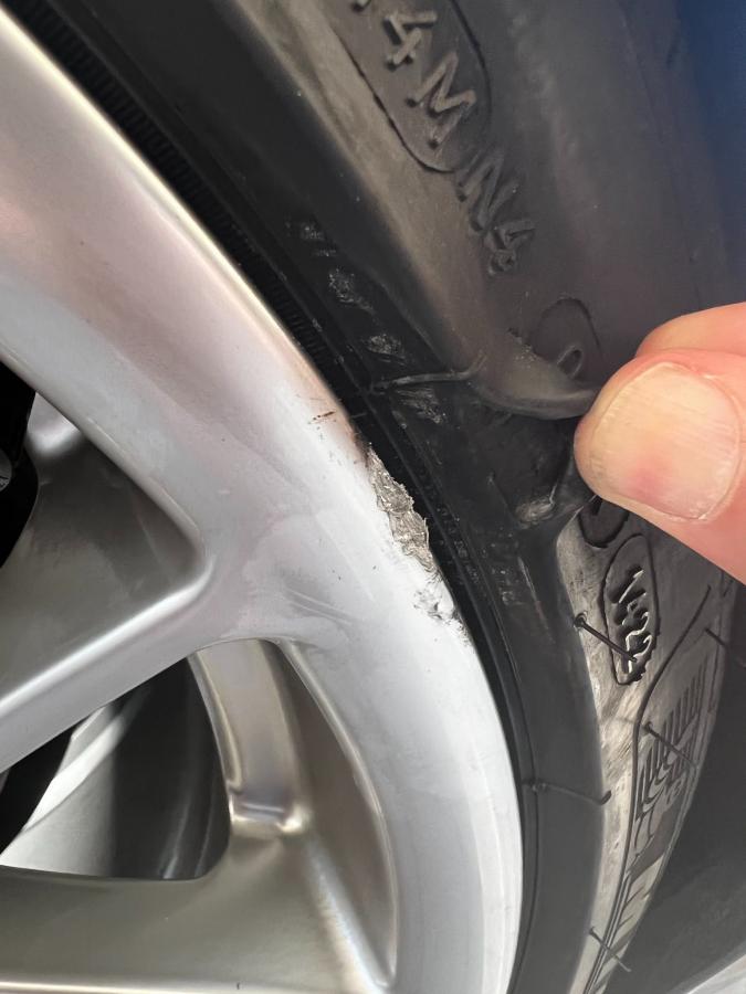

    This weekend I took it on a road trip with some fam. Went to turn into a driveway and turned and turned too early and BANG. Curbed the right rear wheel.

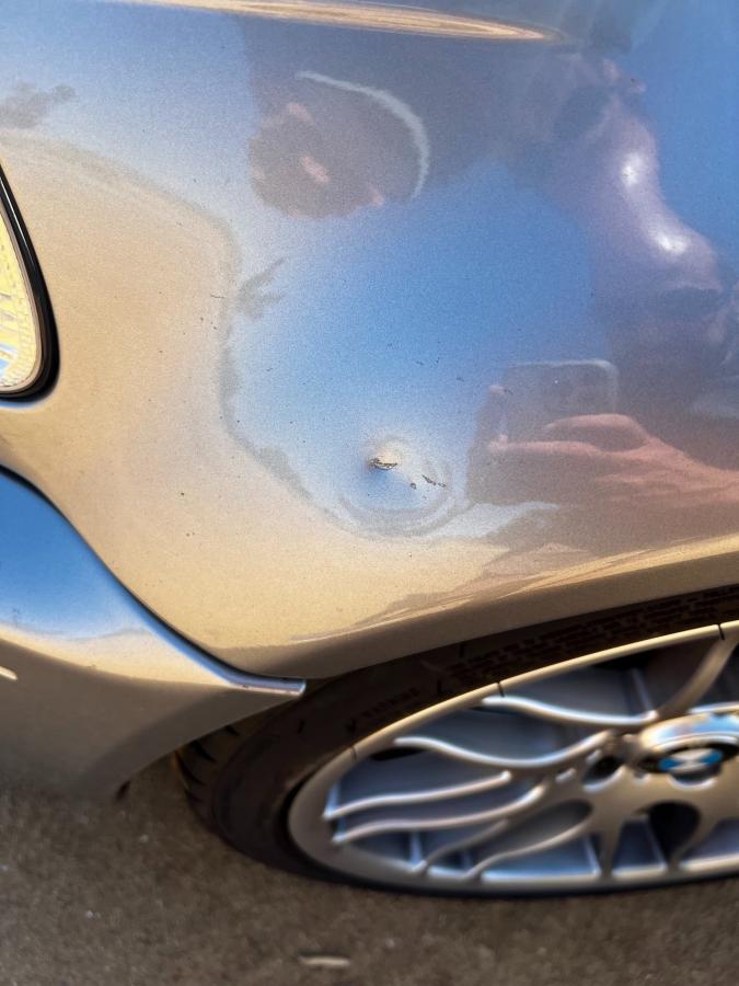

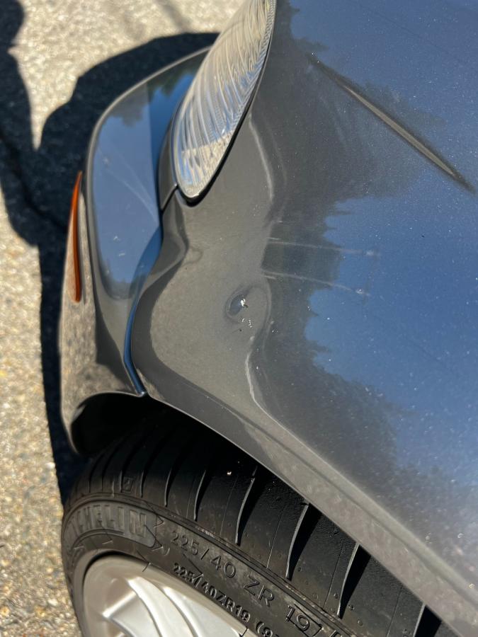

    I ended up calming down and just continued on my way. 2 hours later, a rock comes from nowhere and nails my fender. Of course it was bad enough to damage it.
    Here's the damage for the wheel and fender. The wheel I think is easily repairable. It took a small chunk out of the pilot sport 4s, but they have lips that kind of stick out for this type of thing. the tire doesnt look compromised.
    The fender, well the rock took out the paint. My thought was to get a PDR guy to take out the dent and I could just treat the paint with touch up and live with it. I had my PDR guy stop by today and he says the metal is likely stretched way too much and its a 50/50 if he can get it out. wants like 200 bucks for it

    A good PDR tech should be able to take that dent out. I've seen them take out much worse on other cars. Dr. Colorchip paint will fill in the nick and the rest of the rock chips on the hood and fenders without over filling the chips like regular touch up paint. Unless the wheel lip is bent, certain wheel refinishing shops can repair the curbed part and blend the paint on that small section where it looks 99% perfect. The tire needs to be checked in case it formed a bubble which is sometimes hard to tell without the tire getting up to temp (depends on the impact).

        Original paint even with small rock chips, which can be filled in with Dr. Colorchip, is far better than a respray, IMO. It is hard to match the quality and durability of the factory paint - orange peel, color, defect-free finish, etc.
          If you are as concerned with the car's value down the road as you seem to be, filing a claim is not a great idea, as you'll have a damage report / accident on the VIN for life.
          I agree that looks like PDR could handle it, but if not then you're still better off just paying a decent body shop out of pocket to fix it. You'll be out a grand now, but having an insurance claim on a collector car can cost you more than that in resale value down the road.

            Just to add, that's a $90 dollar ding in LA.
              Time to upgrade to carbon fenders.
                They can fix and touch that up. It won't be perfect but a lot less hassle than a respray especially on metallic.

                  What do you think about the wheel? repairable? got any recommendations on wheel guys?

                      That's a $50 dent at any good PDR place. Less than an hour too.

                          you guys say this but im getting quotes at 250 and its iffy if they can do it.
                          I did find a wheel guy for 75 bucks and he does the wheels for a bmw dealer
                            got a second quote from beach cities PDR for 250+/-.... So far im not finding anyone for less than that
                              You are getting quotes from the guys that don't want to do it. These are "if he is crazy to pay $250 for that, than I guess I'll do it" quotes.
