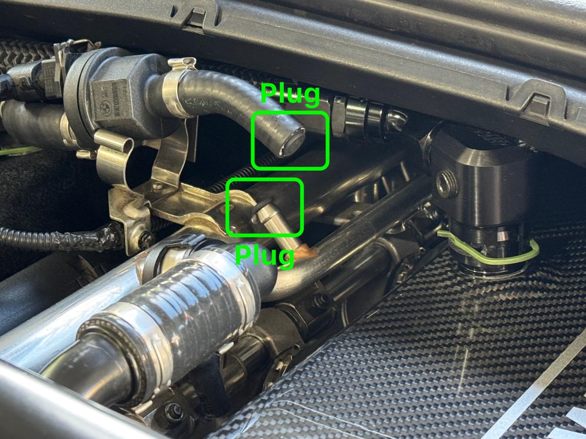

    Hmm, I ran with the original air rail,11157834056 CCV hose and my MSS54HP flashed with CSL Bootloader 32500 without issues for a few months prior to getting the Mullet Tune on my 2004 Vert. I have since switched to the CSL CCV hose and plugged the air rail with a vacuum cap.
    Interesting. I too am running MSS54HP with CSL Bootloader 32500, with and without Mullet Tune. With the 11157834056 late-model breather hose connected to the 13417834068 late-model air rail, without fail I have a surging, rough idle during open-loop operation shortly after both cold and warm start, sometimes misfires, and sometimes EML and related codes. The instant I simply disconnect the breather hose from the air rail and plug the air rail as shown below, all issues resolve. Rock steady idle. No surging, smooth as butter, no misfires, no codes. Night and day.
Name:	BMW E46 M3 S54 Breather Hose and Air Rail Plugged to Solve Vacuum Leak.jpg
    Perhaps your breather valve somehow ends up in a closed/different state when the DME is ignoring it than mine does...

      WBVenom Yeah, it is odd that it was causing you issues. One thing I was thinking was maybe you have catalytic converters as well as have the SAP enabled. I am running without cats and have my SAP pump fully removed and hole blocked off.

        I do indeed have cats and have the SAP present and the SAP sequence enabled. Are you thinking the pressure from the SAP during SAP operation is pressurizing the crankcase (valvetrain area), the air from which then flows out of the CCV port, through the breather valve, and into the air rail? If so, this could absolutely explain my rough idle, which would occur only during SAP operation.
        I had previously theorized that the rough idle stopped when the DME switched from open-loop operation to closed-loop operation once the O2 sensors were ready. But the rough idle ceasing could instead be correlated with the SAP pump turning off. Both the start of closed-loop operation and the SAP turning off likely happen around the same time.
        The SAP turning off is an easily-discernible event. I will test by feeling for SAP vibration and observing the idle just before and after it turns off. And I will feel for airflow from the CCV port during SAP operation as well.
